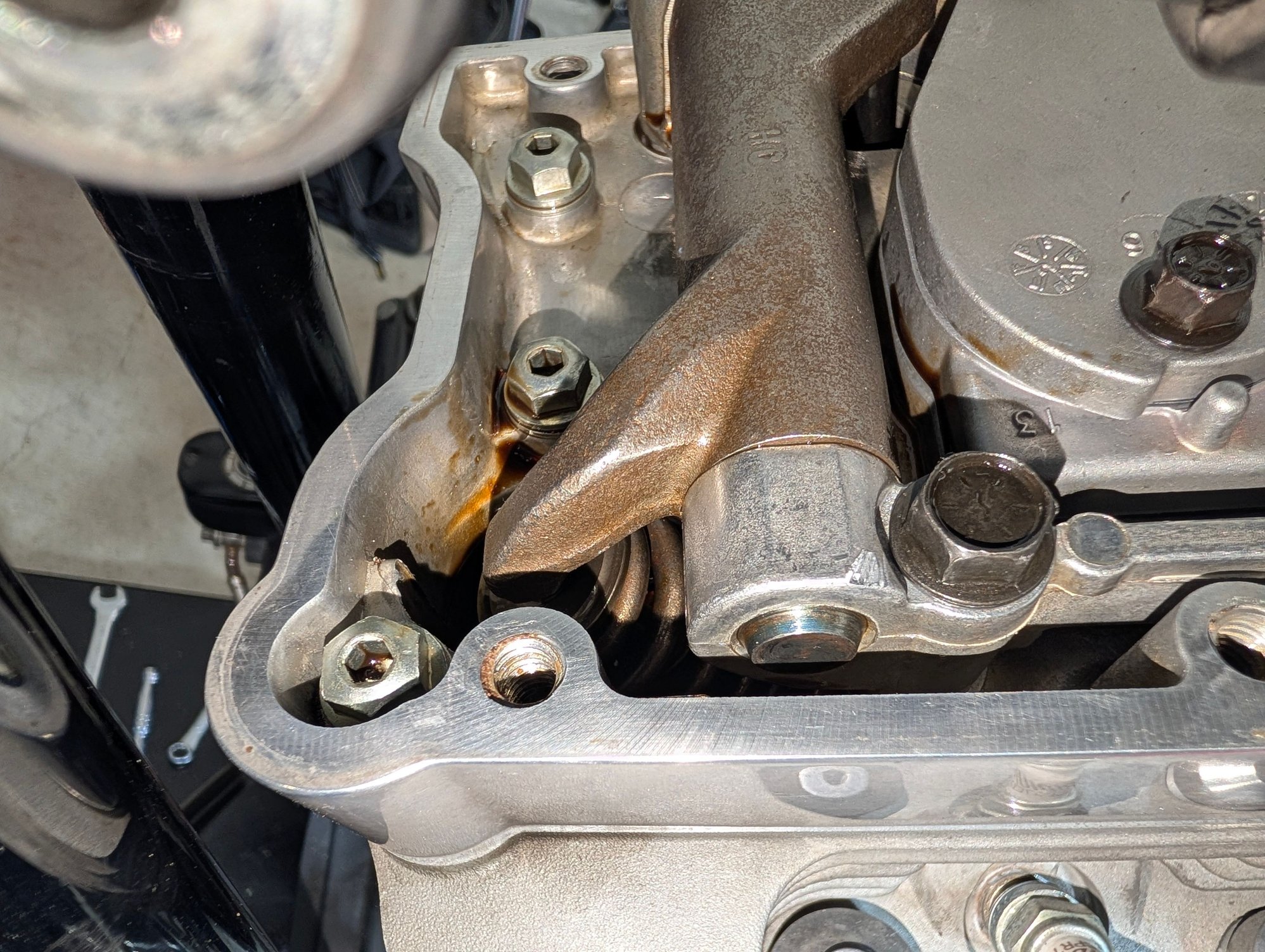

I have a stock 96 in an 07 Softail Standard FXST with about 36K miles. The rockerboxes are leaking both the front and rear. I picked up a James kit for the rockerboxes, just wondering if I should do anything else while I am in there. DK Rocker Lockers are something I keep coming across that seem to be worthwhile.

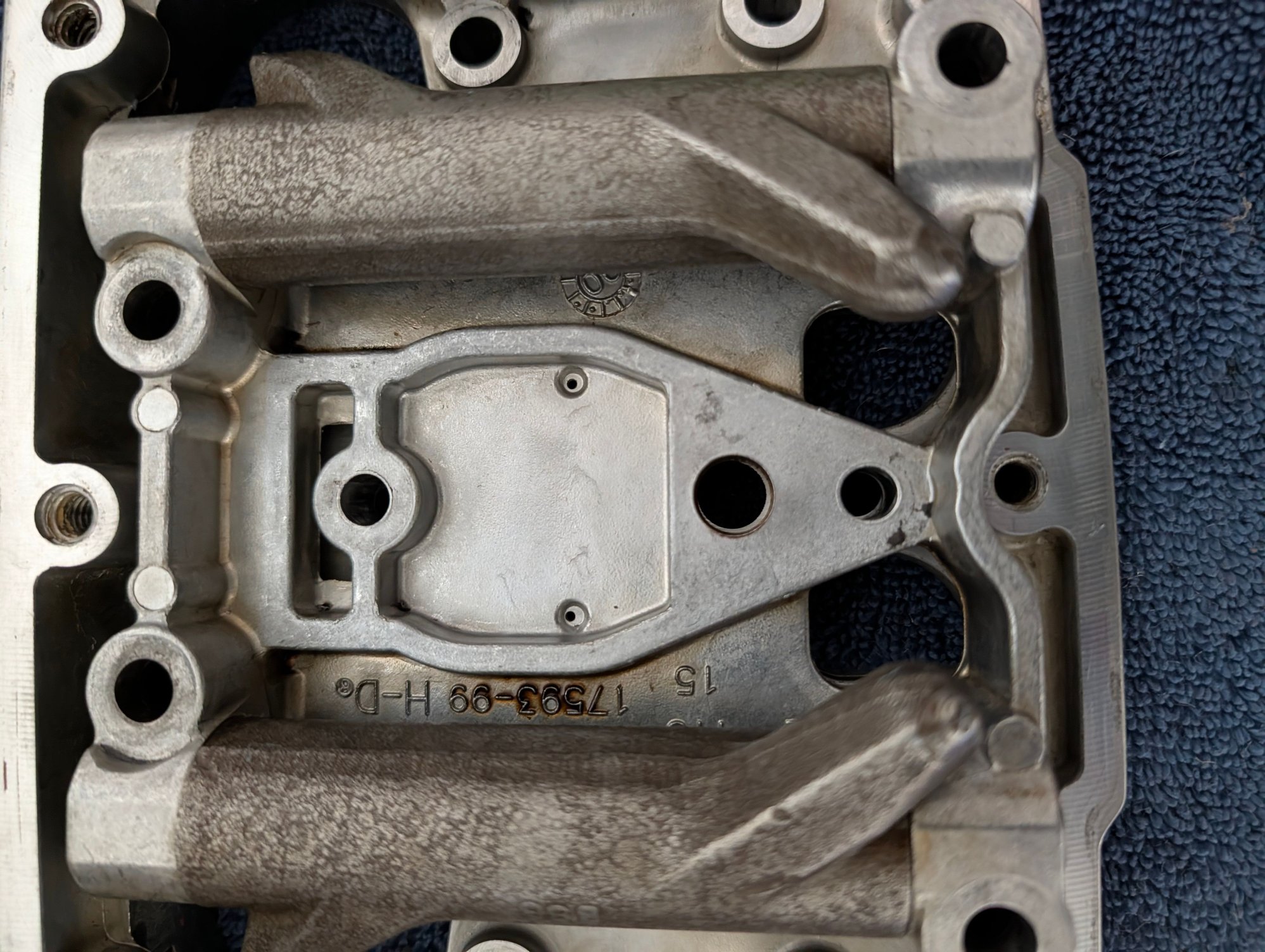

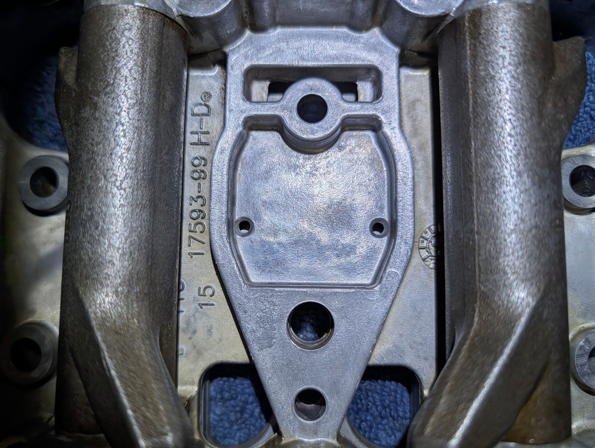

I drilled out the drain holes for the breathers to 1/8 in

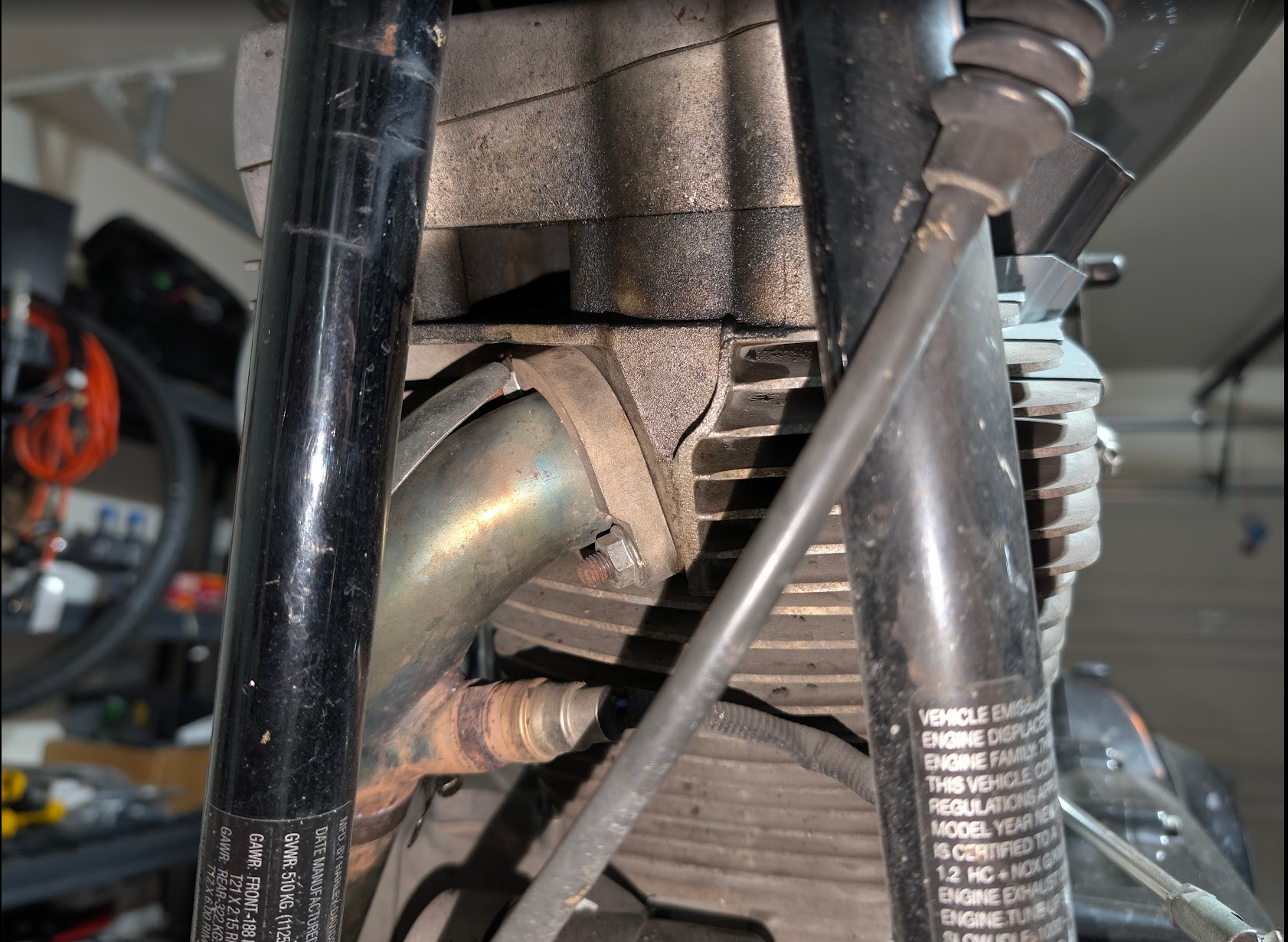

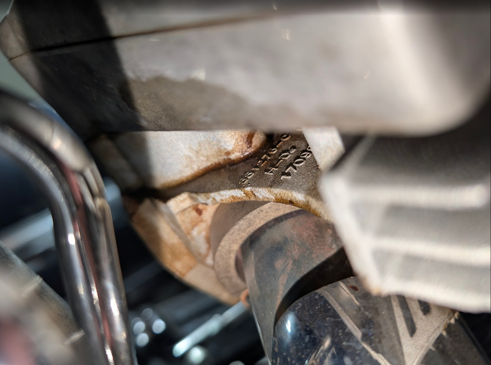

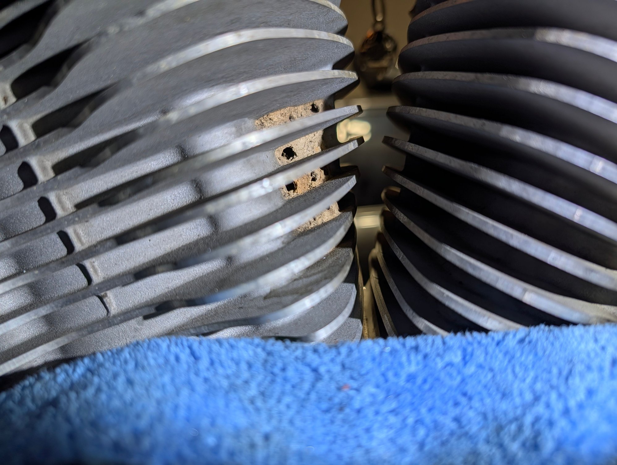

Going through some cleanup of the heads and jugs from the oil leaks.
I guess i never got down low enough to see the bottom fins of the jugs. Since getting a lift and having the bike up higher i was able to see this mess. It also shows me i dont wash the bike well enough since theyve made it through many washes.

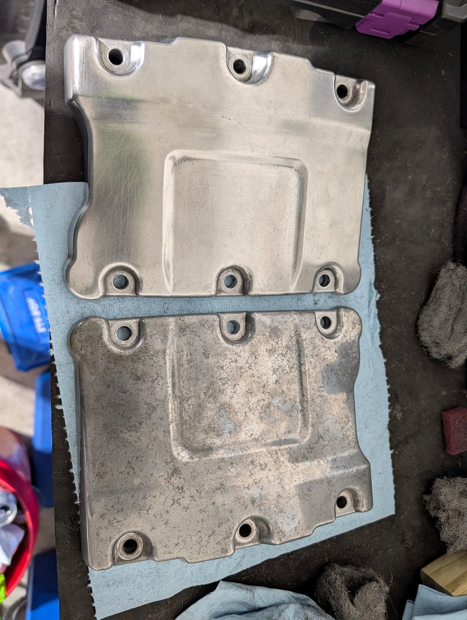

Polishing up the rocker covers, they have a little pitting, mainly heavy oxidation. Picking up some aluminum polish to finish them.

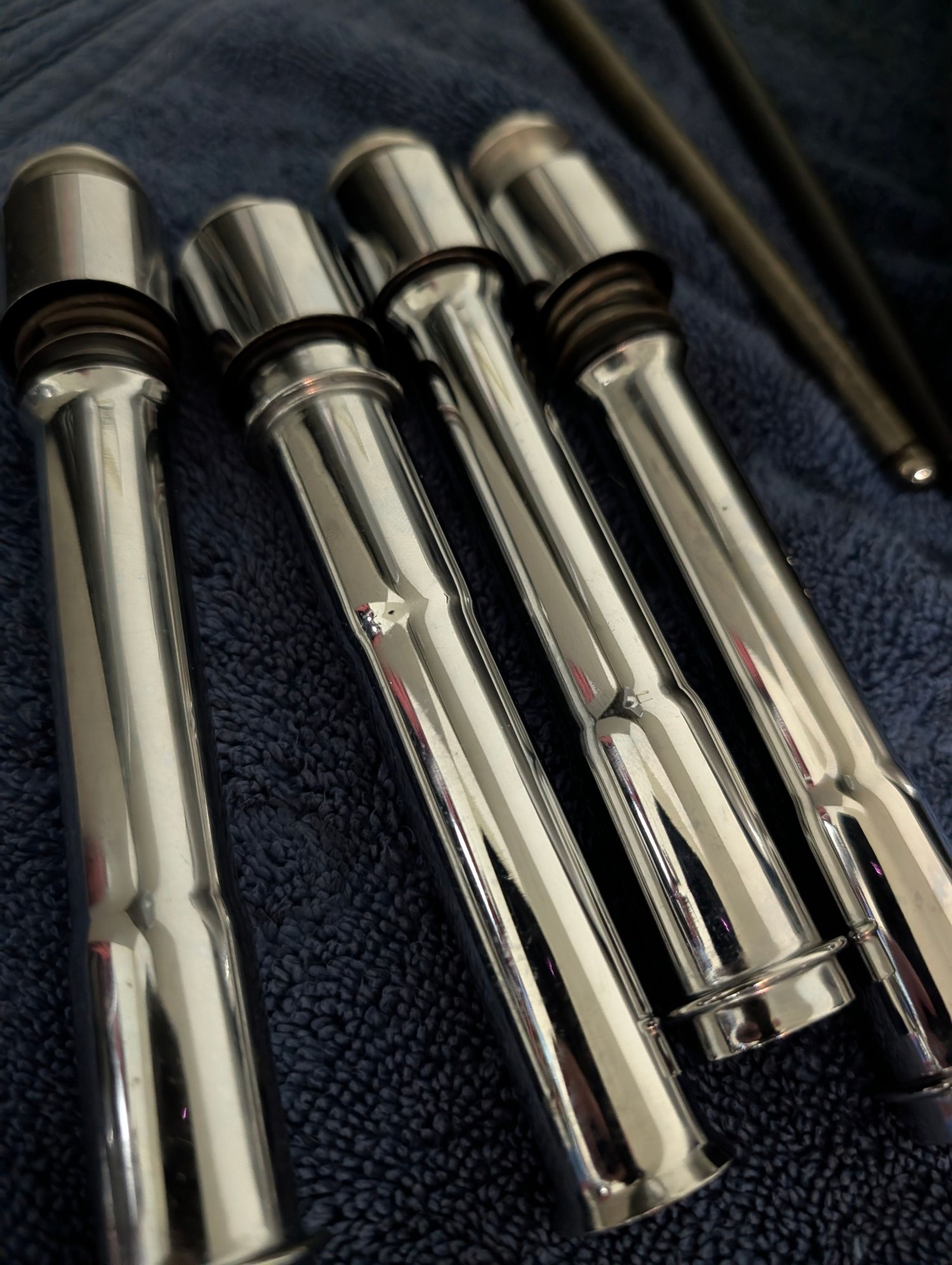

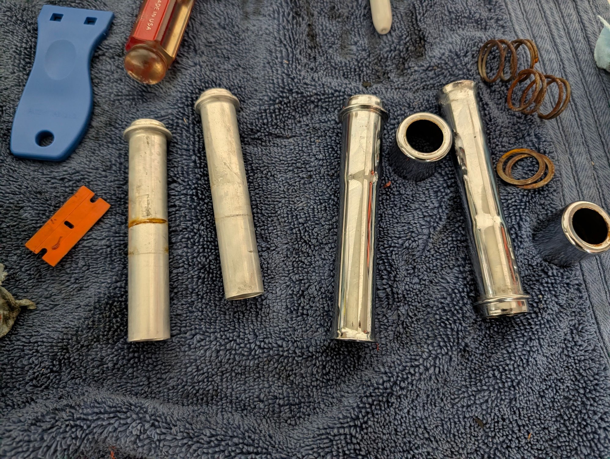

Cleaned up the pushrod covers, ran them through the ultrasonic cleaner with some simple green and hit them with the 0000 wool.
