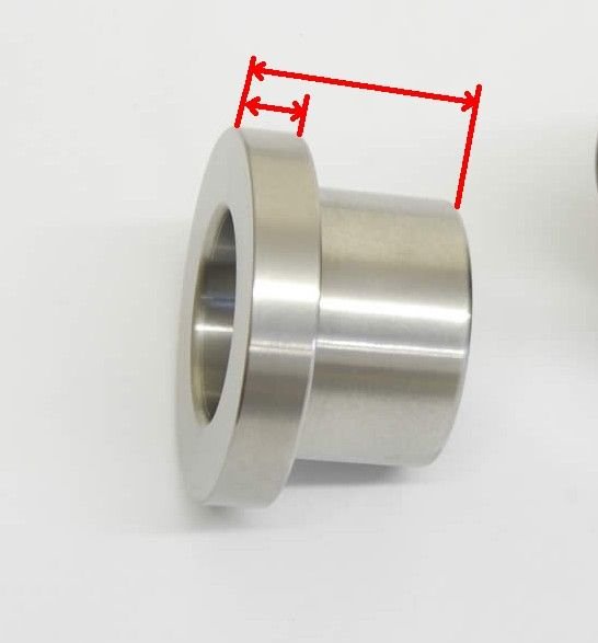

Yeah ok ... besides the Lengths of all the spacers and reducers, I'm also looking for the reducer's "Flange thickness" (see below)
Do you already have the 25mm Narrowglide axle? ... (maybe came with the wheel?)
