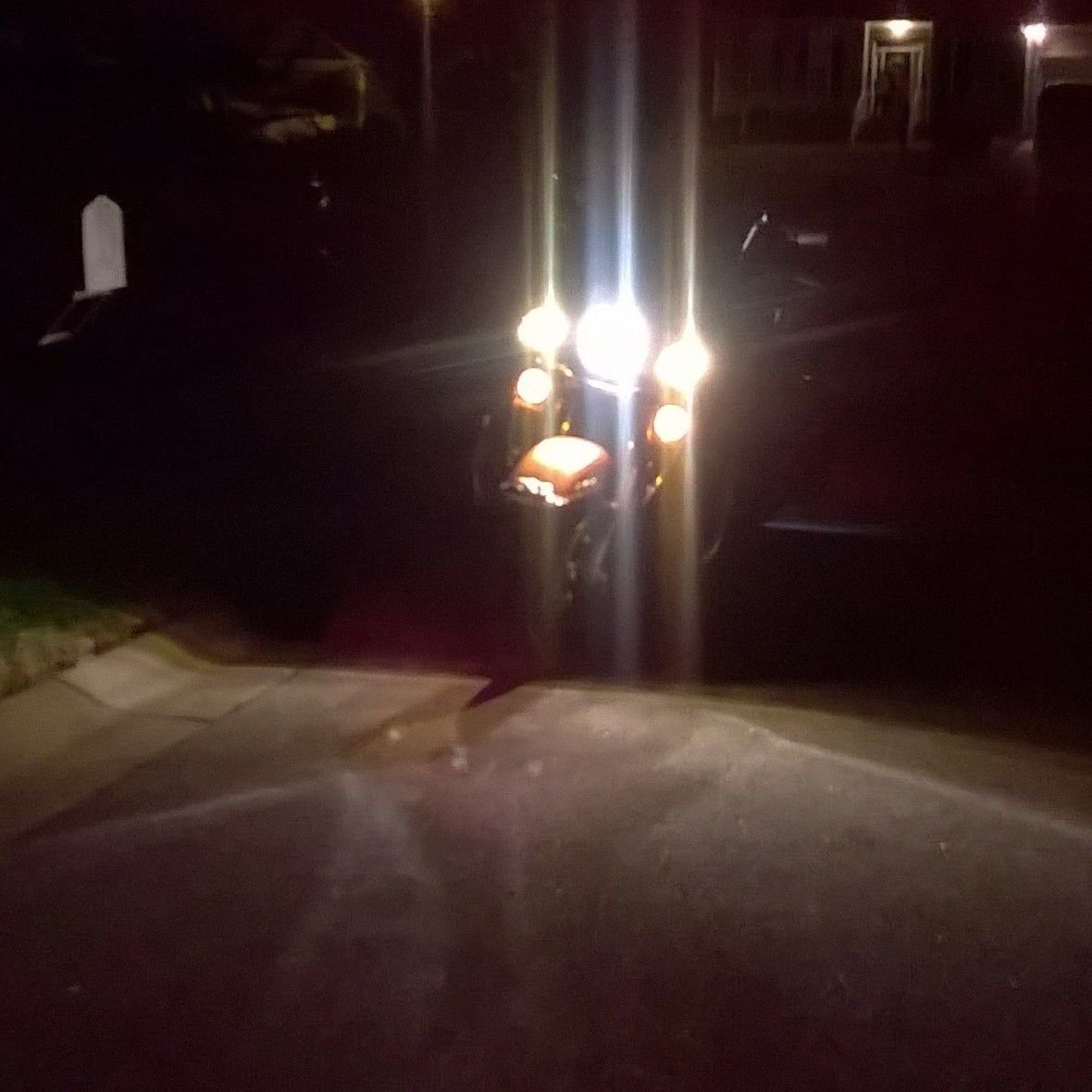

Sunpie is what I got for all 3 lights. Got em off EBAY for less than a $100. For a Rushmore RK you will need an adapter or cut the stock wiring harness.
H8/H11 Low beam and H8/H11 High beam to H4
http://innovativewiring.com/?page_id=4464
I hope this helps.
