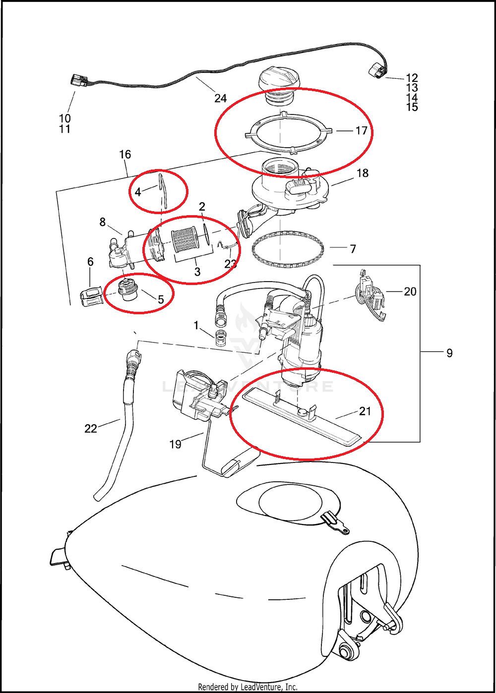

Pump is easy to remove. Leave the tank on the bike but cover the paint. You'll need to take the allen bolts off the front and back of the tank dash, remove it and the vent hoses, electrical connections, then use a hammer and flat screwdriver to turn the metal ring anti-clockwise to remove the pump. It all comes right out of the top. I stuff a rag into the tank neck around the bits I'm working on because I like to drop things. Grab a filter kit, too.

B2119 Fuel pump output overloaded
Might just be plugged up.
First I would take it out and check the filter, fuel pickup strainer, and all the connections before I spent $190 on a pump.
Takes a little finesse to get the filter clip back in, don't drop it into the tank.
Make sure you have a service manual as that will help you.
You don't need the special tool for the locking ring, just a good flat end punch and tap it with a hammer. Tape around the area so as not to damage the pain if you slip with the punch.
Check the fuel regulator also.
