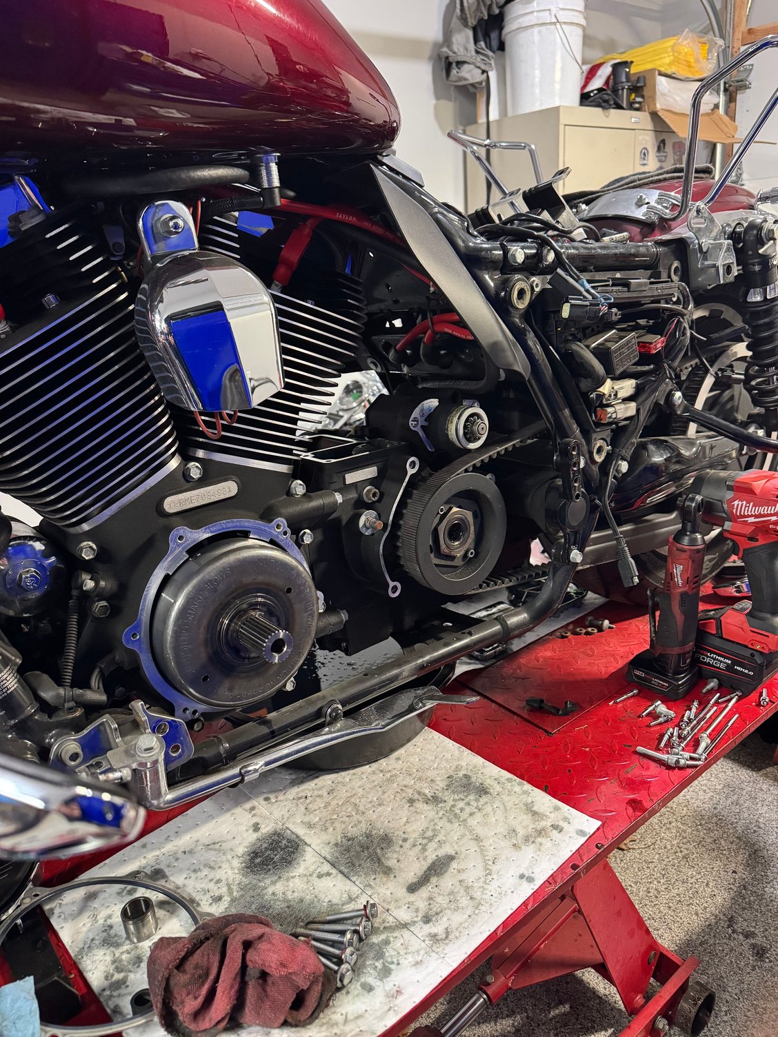

Got the primary apart, compensator out clutch retainer nut removed it the clutch isn’t budging, I don’t want to get abusive with it for obvious reasons. Wondering if there’s loctite on the spline's, never had one of these bikes where the clutch didn’t just pull right off ?

I had the nut out, I ended up using a puller got the clutch off and found the problem, the splined end of the main shaft was burred up. I took a triangle file and cleaned all the spline ends and now the clutch slides on and off as it should.

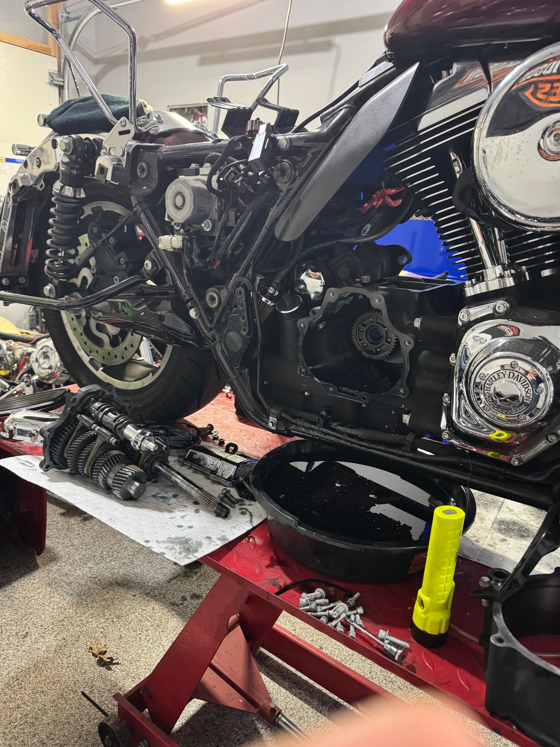

My task is replacing the hydro clutch with a Road King cable setup. But I figured hell might as well add a Baker shift drum while I’m at it. So far got all torn down, got the new cable ran, swapped the Street Glide switches over to the RK switch pack so I don’t lose cruise control. I also picked a brand new 2023 (well 900 mile) M8 clutch assembly, so I’m also swapping that in. Forgot about gaskets and oil so I have to order more stuff.

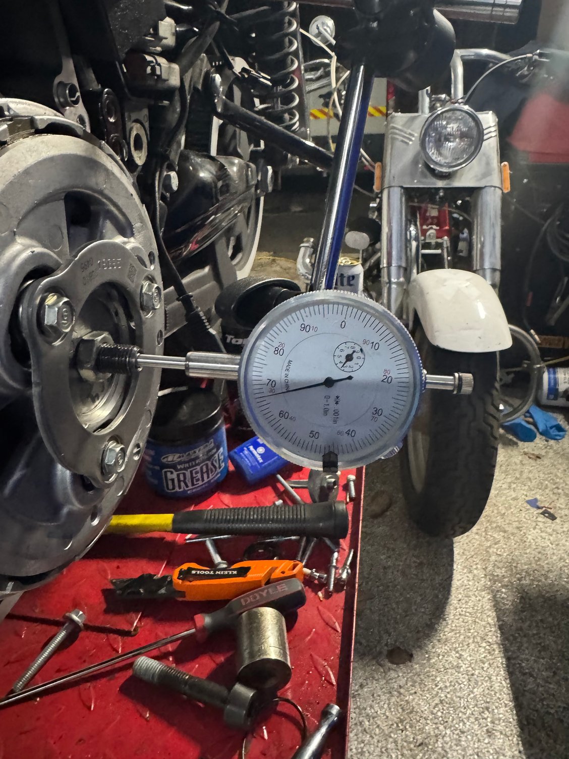

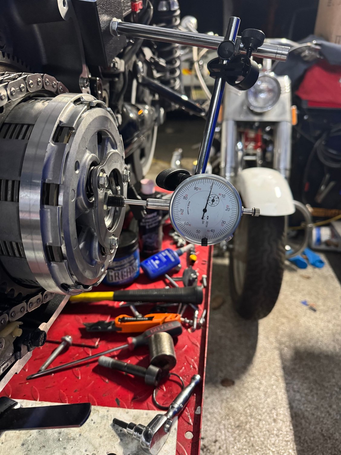

Update, it’s all done, replaced both shift shaft bushings. The trans bushing I used Harley and the cross shaft on the primary I used the headhoggers bushing, the linkage is as tight as it’ll ever be now. The trans the put the Baker smooth shift kit drum assembly in. Put the Fueling comp spring on the compensator. Installed the newer 2023 M8 clutch assembly with a Roadking cable clutch conversion and used a 2011 Road King 18 degree ramp assembly. Clutch is very light, waaay lighter than the Hydro clutch and I had the Mueller slave cylinder. Pressure plate travel is fair at .067” I have free play set of half turn out so plenty of free play, and about an 1/8” at the lever.
