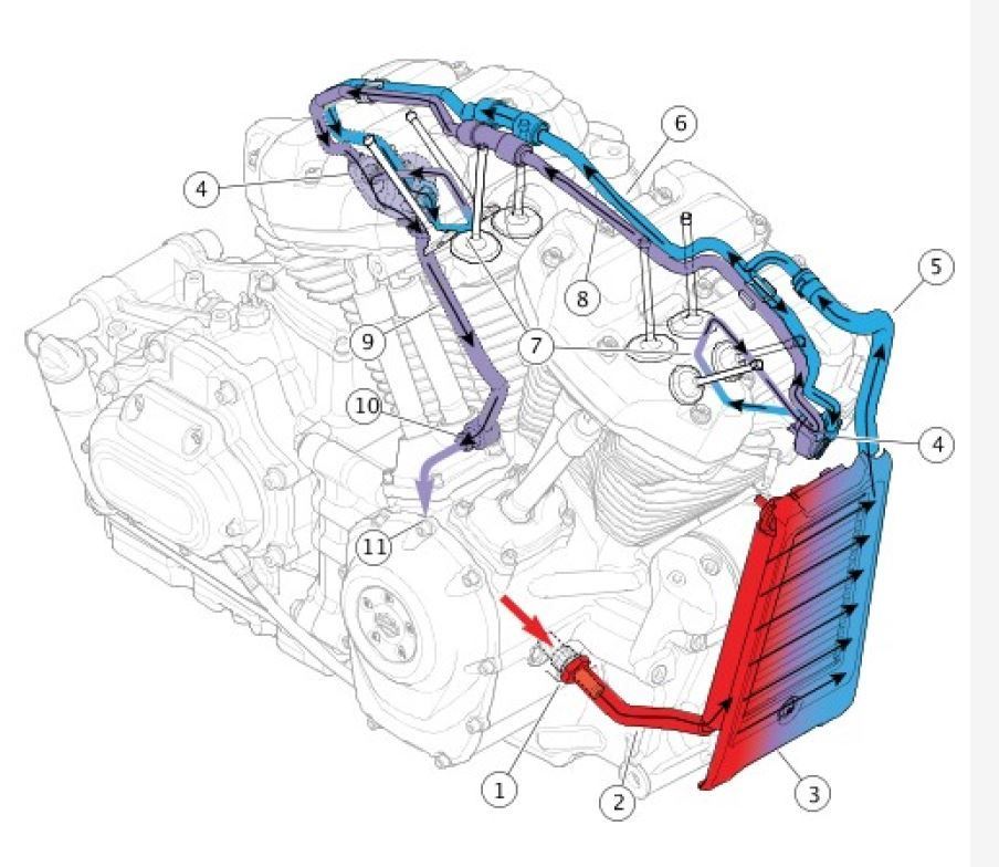

An issue with four valve heads is the inherent "hot spot" in the section between the two exhaust vlaves. Liquid cooling (oil or water) is needed to cool this area.
Here you can see a single cooling passage drilled in the heads that passes between the valves.

Hulkss, thanks for the diagram.
