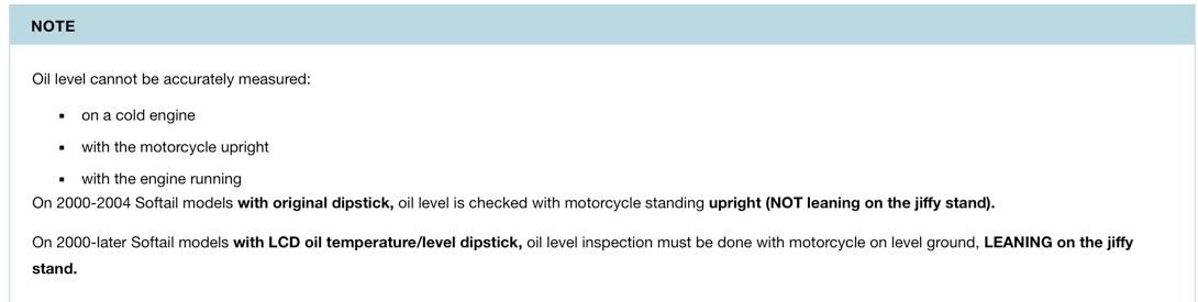

So, today after about 150 miles since the service, I ride the bike and decide to check the oil after my ride....just for grins and giggles. Checking by procedures outlined in the manual, I find that the oil is WAY above the full mark on this 114 engine. What the hell are these guys doing? I took about 1/2 quart out just to get it to the top of the dots. I wanted to take it down about 3 more dots, but decided to ride again tomorrow and check it before I do that.

Tech probably filled it while it was upright on the lift and put the recommend amount in while cold. Then when hot and on its side stand it will be over the hot fill mark. I have been putting 4 qts in cold IAW the owners manual, then running it and checking it again when cold to see if additional fluid is needed.
