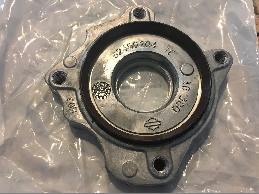

I was told by the parts guy that my 2018 Fatboy has the newer oil pump.
How do I tell the difference between the old oil pump 62400178 and the new oil pump 62400247 ?
I'm putting in an S&S 475C cam and was wondering if I could visually tell or will I have to remove the oil pump assembly and look at the numbers?

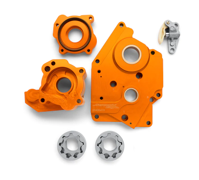

If it's a 2018, and it's camchest was never opened, it definitely does not have the new pump.
The new generation oilpumps have a Seal that presses against the back wall of the camchest, and seals off the pinion shaft.
The HD pumps this seal is pressed into a slot on the backplate of the Pump. The SnS and Feuling pumps they have a groove for the seal on the back of their pump's housing.
If your bike does not have this Seal on the back, don't use it. Don't use the S&S or Feuling ones without this seal either. There was a version of the 2019 pump that had this seal but not the changes that came to the 2020 OEM and 2021 SE oil pumps.
