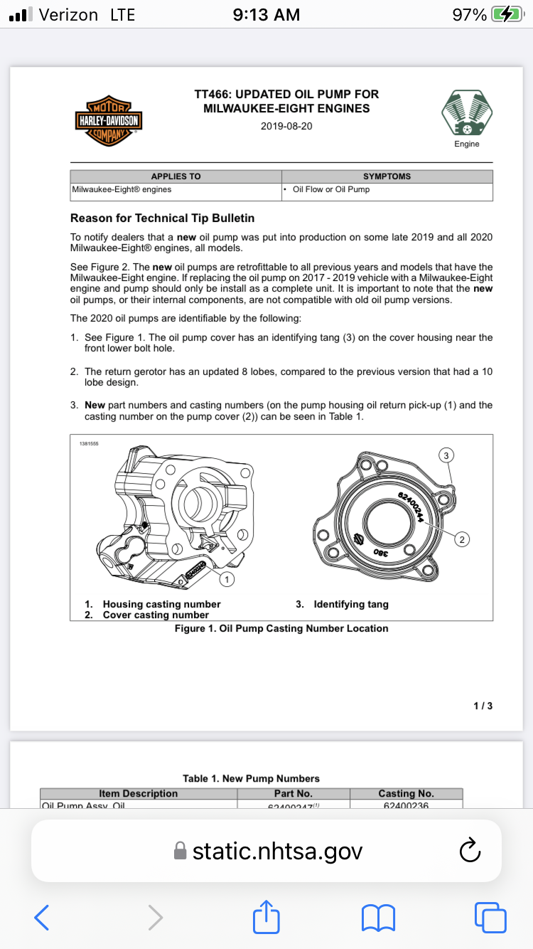

make sure the dealer has an upgraded oil pump for the bike($150?). you mos def dont have the upgraded pump.

The updated oil pump didn’t come out until MY2019. So if you got an 18, you got the original pump that is prone to sumping. I’m guessing you bought the bike used. If you contact the service writer, they should be able to tell you if it ever had an aftermarket oil pump put in. Other than that, until you open the cam cover, there’s no way to know, assuming aftermarket can plate was put in.
Does the bike have a tuner on it? A shop should be able to see if updated tune for a cam.
I will be upgrading to a S&S 465 this winter. That is their torque cam. The 475 is their high HP bolt in. If you’re gonna get an S&S cam, you might as well get the whole kit. That way you know the pump is better, the cam plate it better and you can change the looks of the pushrod covers (if you want either black or chrome)

This may help. BTW, I have the Feuling 465 in my 114 Fat Bob. I’m happy w/idle & gets good mileage and performance in upper RPM’s.

Yup, my Fatboy had the old oil pump. One of the local dealers had the new one, so I dove down and picked it up.

from my research, I wouldn't waste money on SE oil pump, or S&S oil pump. The $800 is a lot, and unneccesary. I called Cycle-Rama here locally, they said they used the upgraded Harley pump in all custom build now. ($150) they are one of the top builders in the world, take a lesson
