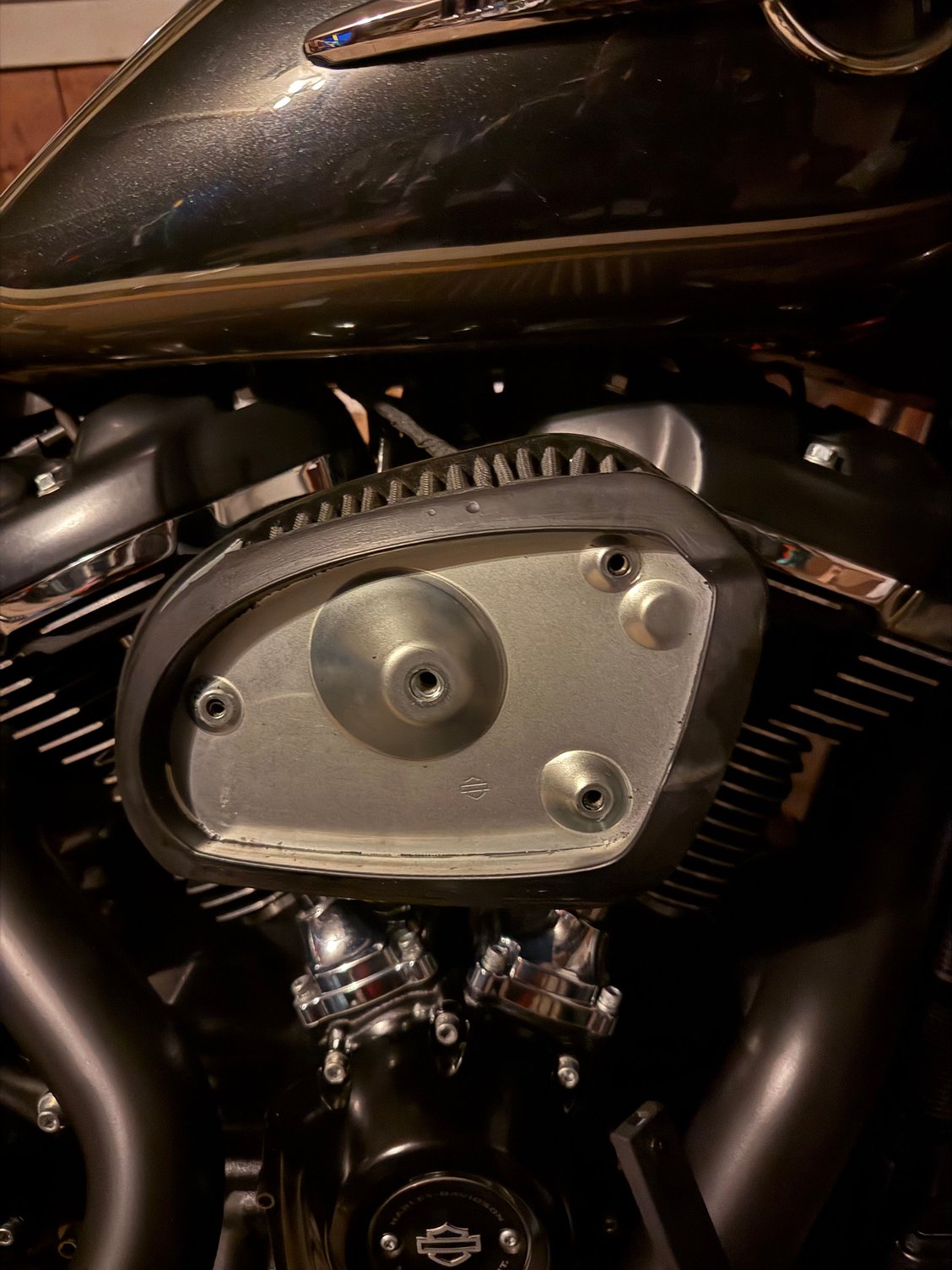

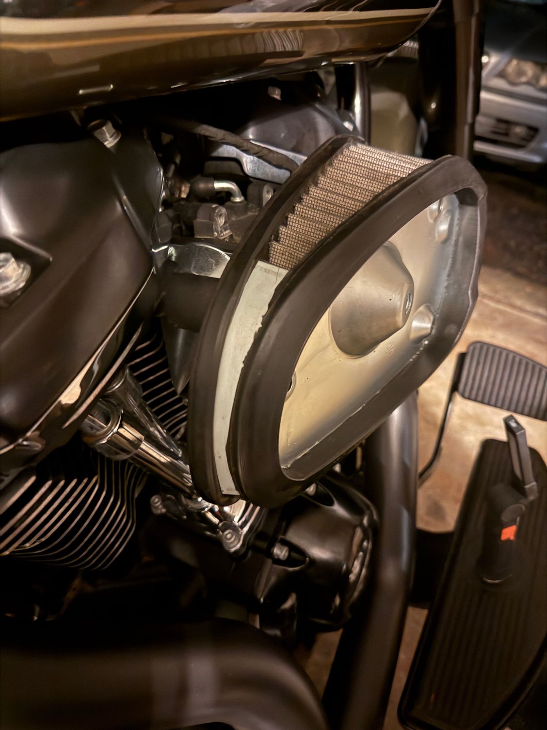

Thanks for the help everyone. Got the actual oil changed, transmission oil changed and now I need to clean the air filter. It’s a SE wedge, but I believe this one does not come off to clean it. I’ve seen videos of people cleaning the wedge ones by removing them and using the K&N kit, but mine is adhered to the backplate. Just wanted to check and make sure I’m not crazy. This is the manual for that particular air cleaner, I am reading this correctly, right? It never says to remove the air cleaner (but it also says to shake the excess moisture off after cleaning, so that’s where my confusion lies).
https://serviceinfo.harley-davidson....5?locale=en_US
Sorry, I know this all probably seems pretty stupid to a lot of you, but I’m new to working on bikes and want to learn to do this stuff on my own.
pics for reference

It comes off. They do stick though. Gently pry it off with a screwdriver

You are correct. Got it off, it’s pretty well soiled. The bottom half is black, even after cleaning with k&n cleaner and when that didn’t work I tried soaking it in dawn. Thinking I might just replace the filter element and be done with this learning fiasco.

Although the factory filters are labelled serviceable they quickly deteriorate after being cleaned a couple of times. Better to replace with a truly reuseable filter like K&N that can be washed and re-oiled. That black at the bottom is likely blow-by from over filling and oil puking from the breathers. You'll want your oil level to be halfway up the dipstick hot and that'll alleviate a good portion of it.
