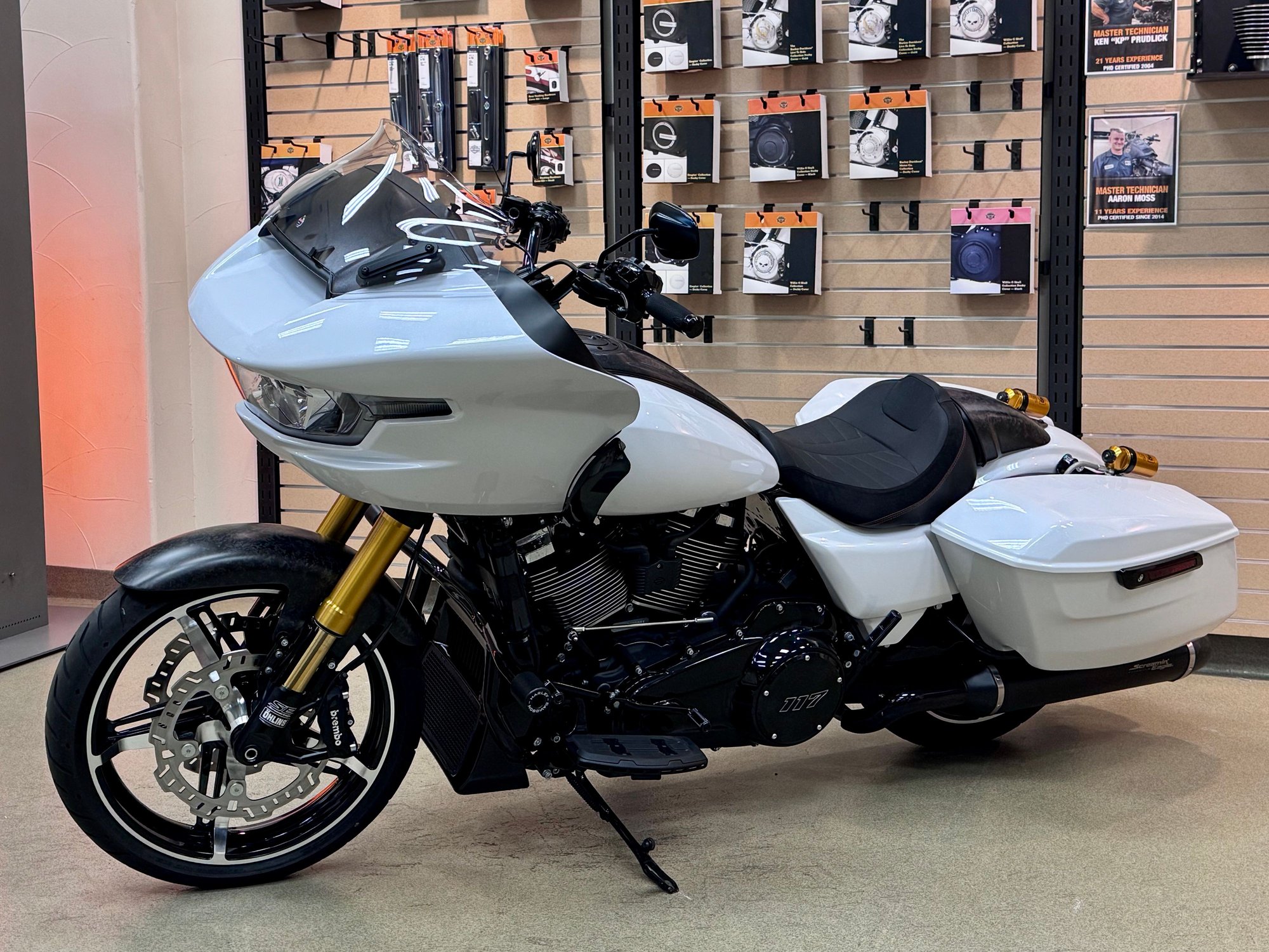

Thought I would post my thoughts on the screamin' eagle Ohlins front and rear suspension. I had Superstition Springs Harley do the install. It was a hefty investment but I have to say that the suspension has transformed the ride and handling characteristics for the better. Im running the recommended settings from Harley and I am seriously impressed with how precise the handling is now.
My only complaint with the bike was the stock suspension which is good but lacks the confidence inspiring control of the bike that the Ohlins does give. The front suspension is absolutely sublime. It makes the bike actually feel nimble. Its fully adjustable for whatever ride you want. Soft and comfortable or firm and precise. I feel like the factory recommended settings give the bike a firm but compliant ride, smooth over larger bumps and firm enough to push it hard through the bends. The upgraded brakes do pull harder than the stock brakes. The rear shocks are equally amazing. No surprises yet and definitely help give the bike a very controlled ride.
I feel like im riding a v-twin sport bike. Overall Im very happy with the ride, the looks are killer too but the ride is just fantastic.
