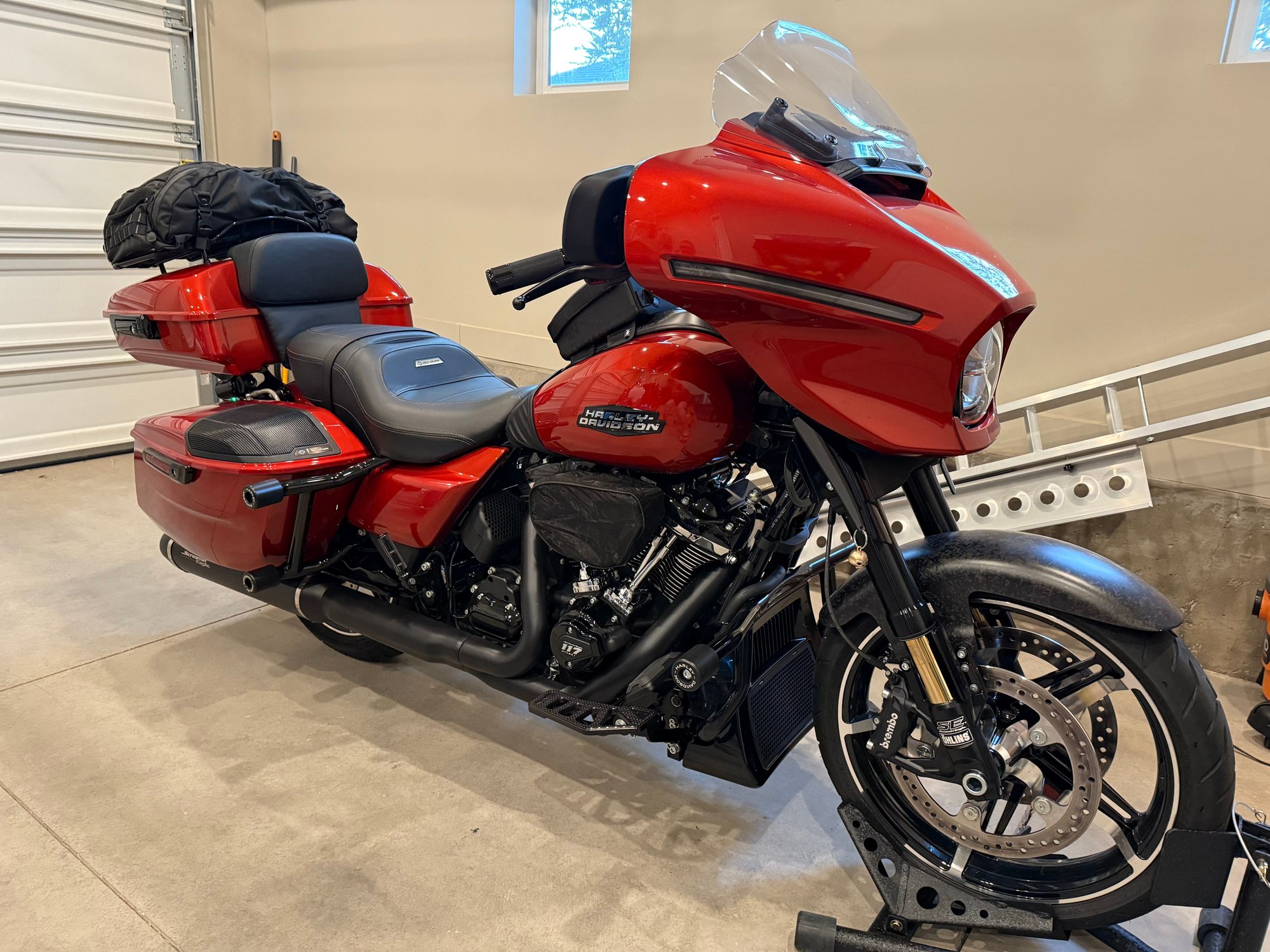

Old Sep 22, 2025 | 07:56 AM
mikes84790's Avatar
mikes84790
Joined: Jun 2024
Posts: 58
Likes: 50
From: St George, Utah
I did the same upgrade on my 24 SG and agree that it was really worth the $$. The brakes are amazing now for such a heavy bike! Still working with the front adjustment to get better compliance over sharp bumps like freeway heaves. With the SG front end adjustment is a pain, unfortunately. Ride on!
Dude your bike is bad ***, Im fighting the urge to get the rear speakers. I will eventually add a tour pack. Nice!
Old Sep 22, 2025 | 01:07 PM
mikes84790's Avatar
mikes84790
Joined: Jun 2024
Posts: 58
Likes: 50
Thanks! I am loving it so far! The saddlebag speakers are a great addition to the Stage 2 or 3 fairing speakers. The install is pretty easy except for the wiring harness...
