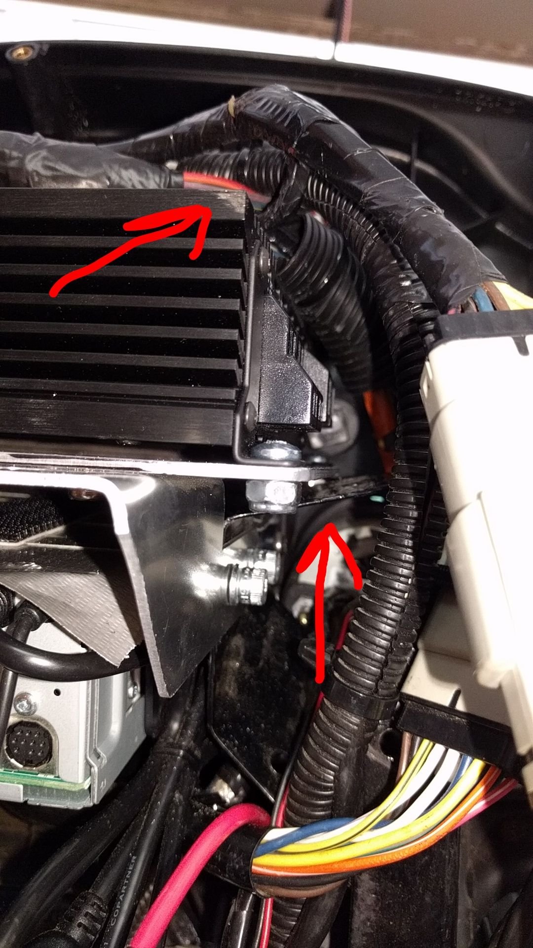

The D4 being 9 inches long is much wider than my Kenwood 998 causing it to rest on the radio/fairing brackets before coming in contact with the top of the radio. I did what Sly suggested and that gets me very close to where I need to be.
The upper arrow shows how much of the outer top corner is digging into my sound mat. The lower arrow shows the radio/fairing bracket that the amp comes in contact with before resting on top of my radio. The dimensions of this amp is 9x5x2 so it seems the 2" height is the main reason for amp not fitting. I'm going to modify my mount to get the ends of this amp as close to the radio/fairing brackets as I can and I think that will lower the amp a quarter of an inch and hopefully that should work.

Amp is way too high in relationship to the radio. That amp bracket is not your friend. If you can lower the bracket a 1/4 inch or so you'll be fine.

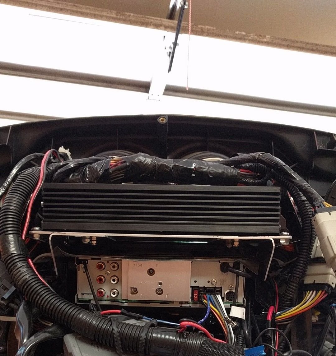

I never knew qualifications for mounting amps were, part engineer, fabricator, pro molex plug relocator and having a major in patience. Sly's recommendation and the modification of the amp mount the fairing is now fitting really well. I'm ashamed to say I've been on this for 6 hours and at times I thought I was getting in over my head but thanks to you guys and taking my time all is well.
