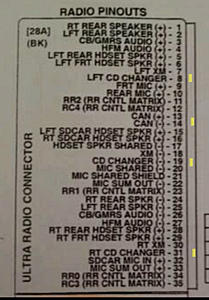

Progress notes:
Ordered and received new device from On the Move. Plug and play wire harness a bit bulky for my taste so needed to do some research on lines to remove and install into plug. My service guide didn't name the lines so had to find online diagrams to understand what being used for; in short, CD input. Documenting for others as needed and let you know the final outcome when I get installed, needed to order a dummy module so amp can lay flat on top, slight delay but just filler for others who may do.
