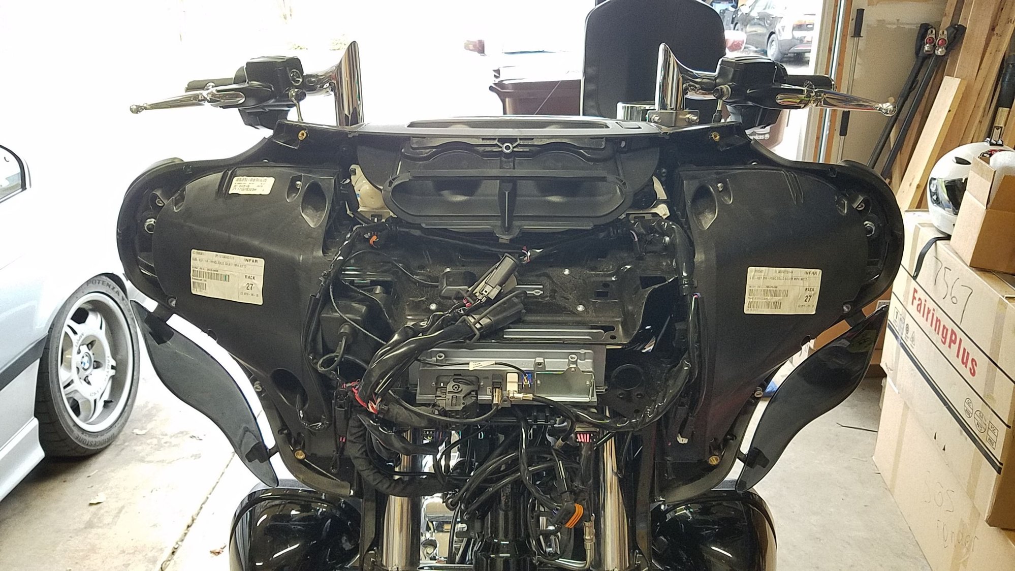

Old May 19, 2018 | 11:15 PM
Iworktofish's Avatar
Iworktofish
Joined: Apr 2017
Posts: 33
Likes: 7
From: Gilberts, IL
Originally Posted by marshallb
Got any pics of the mount before you put the amp on it? Nice work for sure!
stock amp tray prior to cutting
Old May 20, 2018 | 12:15 AM
marshallb's Avatar
marshallb
Joined: Jun 2017
Posts: 1,832
Likes: 174
From: Indiana
Is that cut? Maybe I worded my question wrong I'd like to see the cut mount before amp install. Sorry for the confusion.
Old May 20, 2018 | 01:07 AM
Iworktofish
Joined: Apr 2017
Posts: 33
Likes: 7
From: Gilberts, IL
sorry I did not take pictures. However, the red areas below is exactly where I cut so that the amp sits flat
