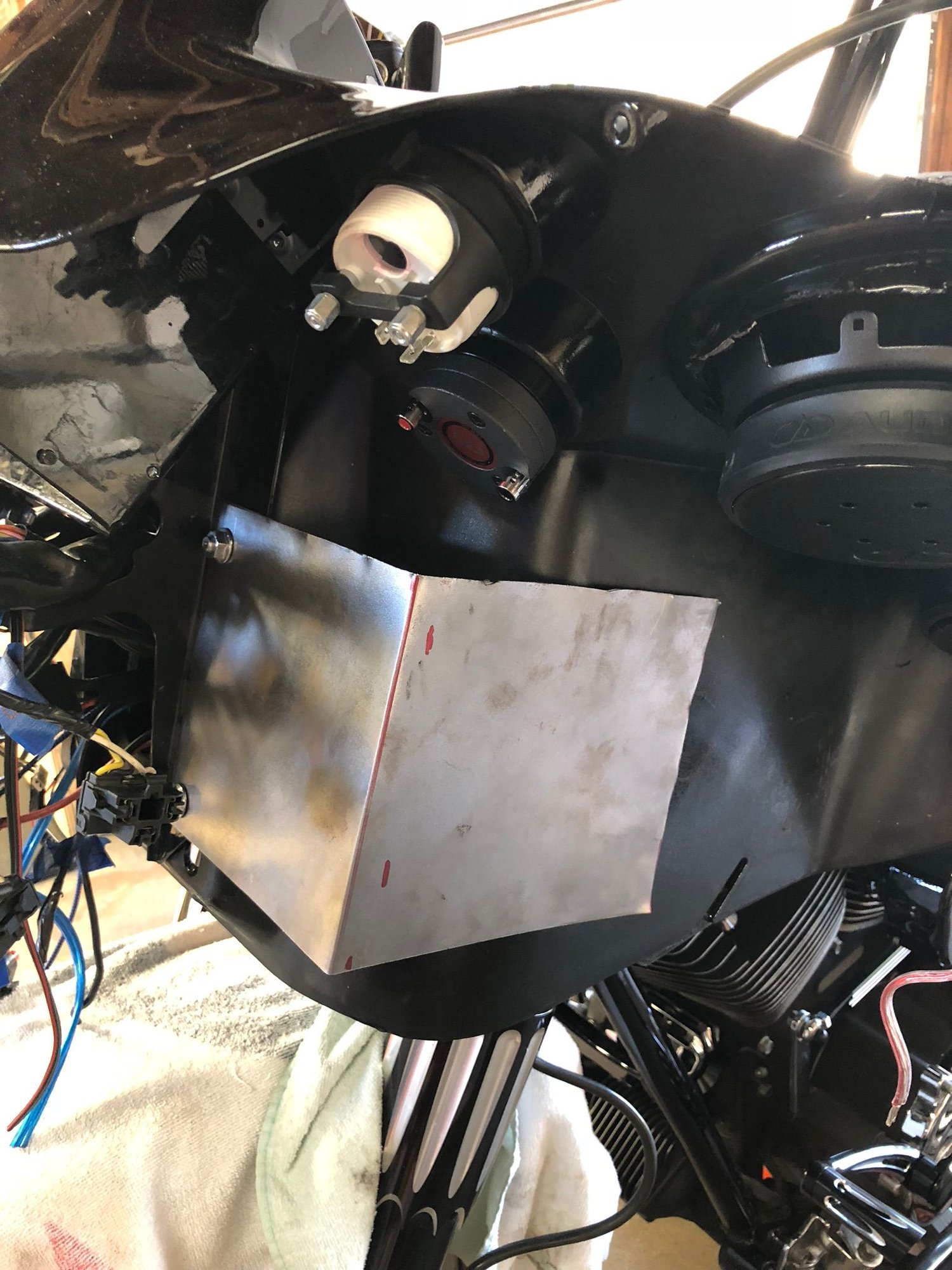

So I am replacing the entire front fairing inner and outer on my 2010 Roadglide. With the help of this forum I have made some choices on stereo setup. Below are some progress pics. I am going to run 4 gauge ground and power to fairing. Will then go 8 gauge to amps. Let me know thoughts fellas
Here is the new setup
1 - Pioneer AVH2300 7' TouchScreen with Carplay
1 - Soundstream ST4.1000D 4 Channel
1- Soundstream PN4,1000D 4 Channel
4 - DD 6.5vos
2 - DD Bullets
2 Polk Audio 6x9 in lids ( will replace soon )

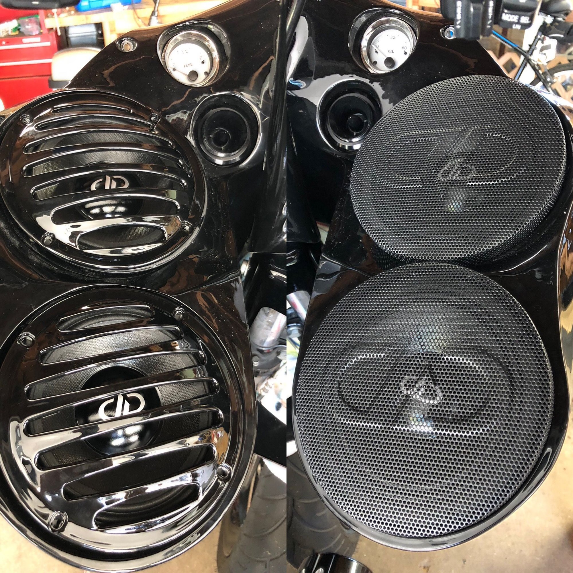

Was trying to decide on what speaker grill. The bike is going to be painted White Diamond Pearl with alot of black accents. so decided on the glossy black grills. Although the DD grills are sick

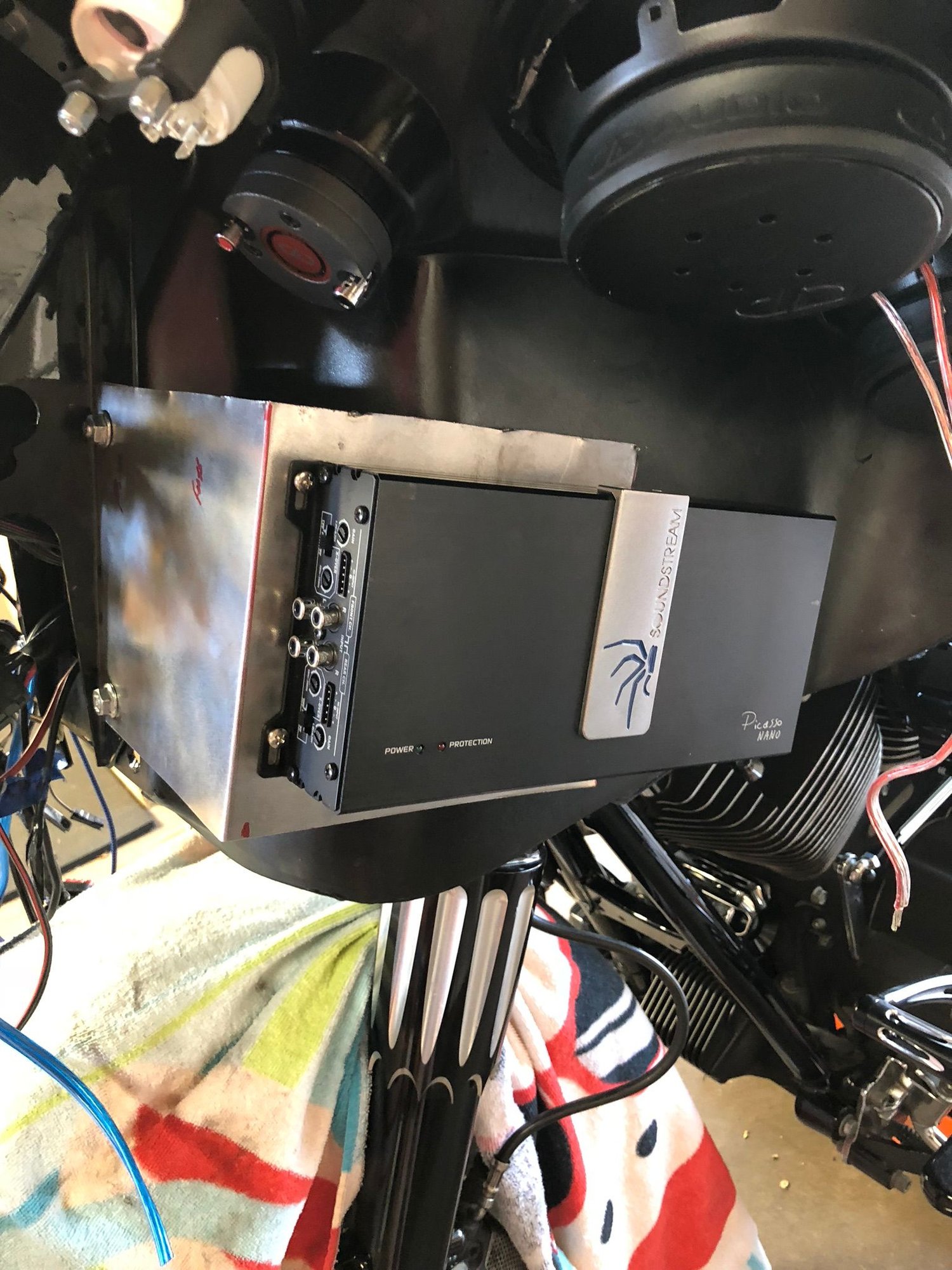

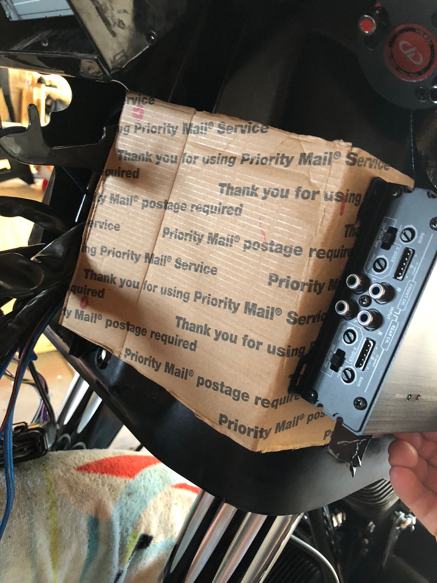

The Amp is pretty large needed to mock up a template for a mounting rack
Here is the 1st rack. Will grind down and smooth out and paint.
I will mount Dist block and fuses etc on the front of the plate.

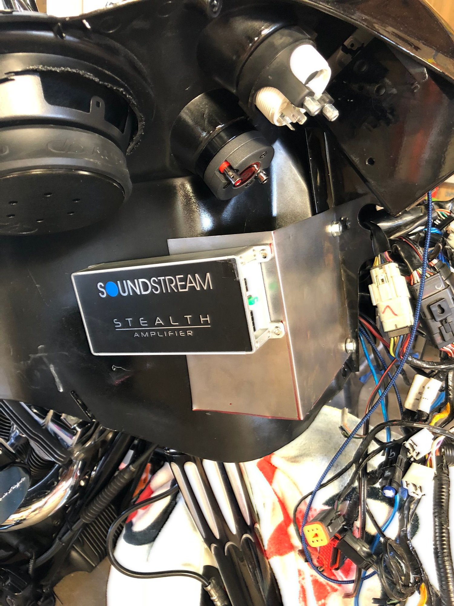

What are you planning on using the ST4.1000 for?
Old Jul 11, 2018 | 07:52 AM
Bootsie's Avatar
Bootsie
Posts: 89
I was thinking the rear 6x9s. Or Maybe the Tweets? I dont know yet. Do you have a suggestion?
Old Jul 11, 2018 | 07:55 AM
SBates08's Avatar
SBates08
Joined: Jan 2013
Posts: 10,637
Likes: 1,246
From: Lake, Ms
If you run it to the 6x9's it will have to be ran bridged. Unbridged it's only 90watts and won't be worth the effort.
InthewindMN's Avatar
InthewindMN
Joined: Jan 2014
Posts: 2,482
Likes: 239
From: Minnesota
can you fit another pn1000 on that side instead of the st?
Old Jul 11, 2018 | 07:59 AM
Bootsie's Avatar
Bootsie
Posts: 89
For sure could. That actually might not be a bad idea for future upgrade proofing.
Could I not run the horns off this? I was pretty sure I could. Damn. Well Amazon has an exchange policy so maybe
Old Jul 11, 2018 | 08:01 AM
SBates08's Avatar
SBates08
Joined: Jan 2013
Posts: 10,637
Likes: 1,246
From: Lake, Ms
Yes you could run the horns off of it and you could run the 6.5's in parallel off of 1&2 and run the 6x9's off of 3&4. Ideally you'd want everything to have their own channels, especially not knowing how power hungry those 6.5's will be.
