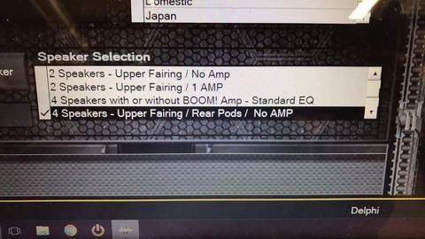

Do you have to do the resitor on the rear left and rear right on that flash i mean would the radio be putting signal to those wires on that flash i know they arent on the stock 2 speakers no amp flash. Also what is the eq curve difference on the 4 speakers no amp flash recomended by so many others.
Or is it if you choose one of these flashes having amp. that you can still use the speaker outs of the HU but switch your dsr to low lv instead of the high level input

My experience is the 8/2 sounds better than any flash even other flashes with resistors. We never use them. The catch with the 8/2 flash is you need to find an Indy shop to do it and until recently there weren’t many. Fosgate is now packaging the flash tool to shops the sign up as dealers. It was much easier to have folks get the 4/0 flash at the dealer and add a resister but i don’t think it sounds better. If it were that easy Fosgate would provide their dealers resistors instead of a really expensive flash tool!

I think you don't need the resistors when you flash with amplifier because, according to my understanding, the HU act as a preamp. Therefore, the output is a low level. Next Friday I will be at a RF dealer for the flash. RF recommend 2 speakers 1 Amp but I will ask for 8 speakers 2 Amp. I will see what they will suggest then.
