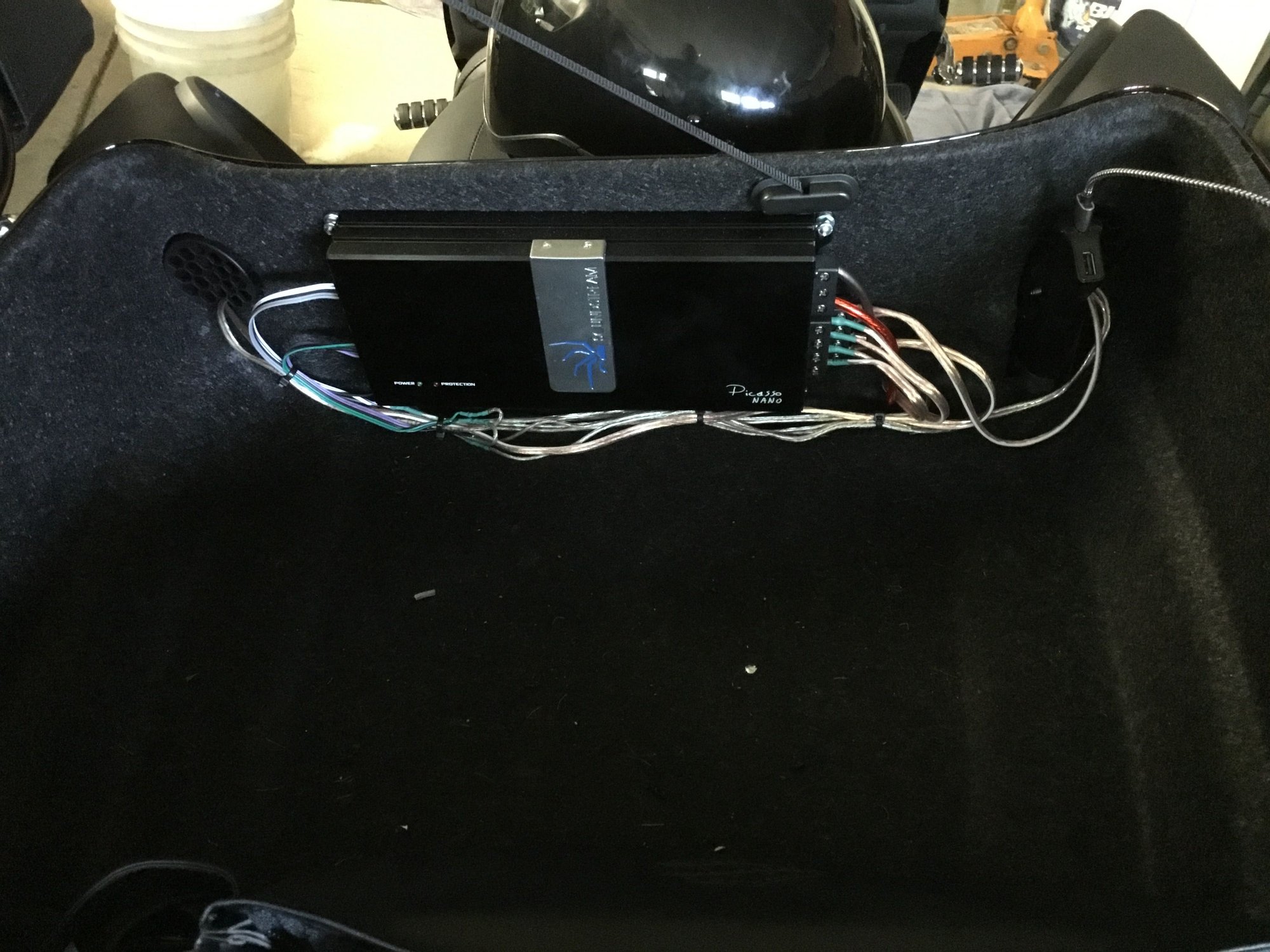

I didn’t want to try and cram my SS PN4.1000D under the batwing. Mounted it to the wall of my tourpak. As expected radio reception is terrible. Just wondering if I put a hidden antenna in the fairing will the reception clear up since the amp is at the other end of the bike? Thanks in advance.

Well I tried the Harley hidden antenna. Made no difference ☹️. If anyone wants to put their antenna in the fairing, it’s for sale in the audio classifieds.

Most of the lower end class "d" amps will interfere to some degree. The JL's, some Alpine, Sd's all do well for radio reception.

Thanks Juice, I’m going to watch for a deal on on a better amp. In the mean time I’ll enjoy 8 gig on a thumb drive and pandora ��
