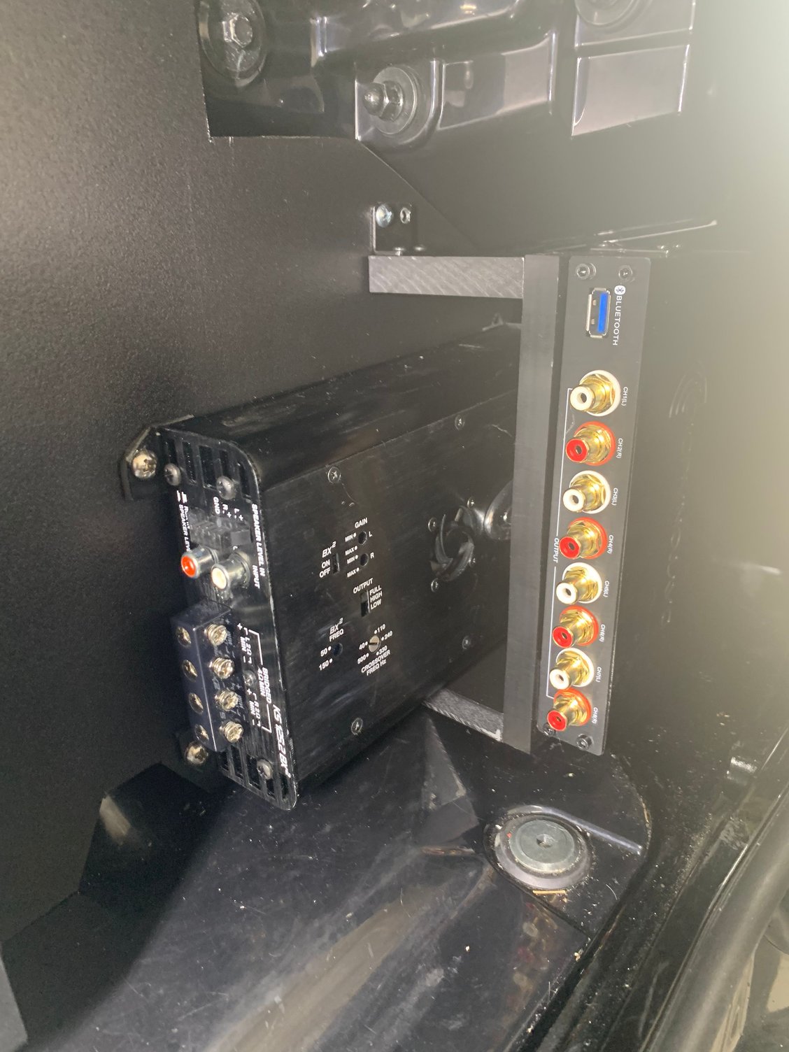

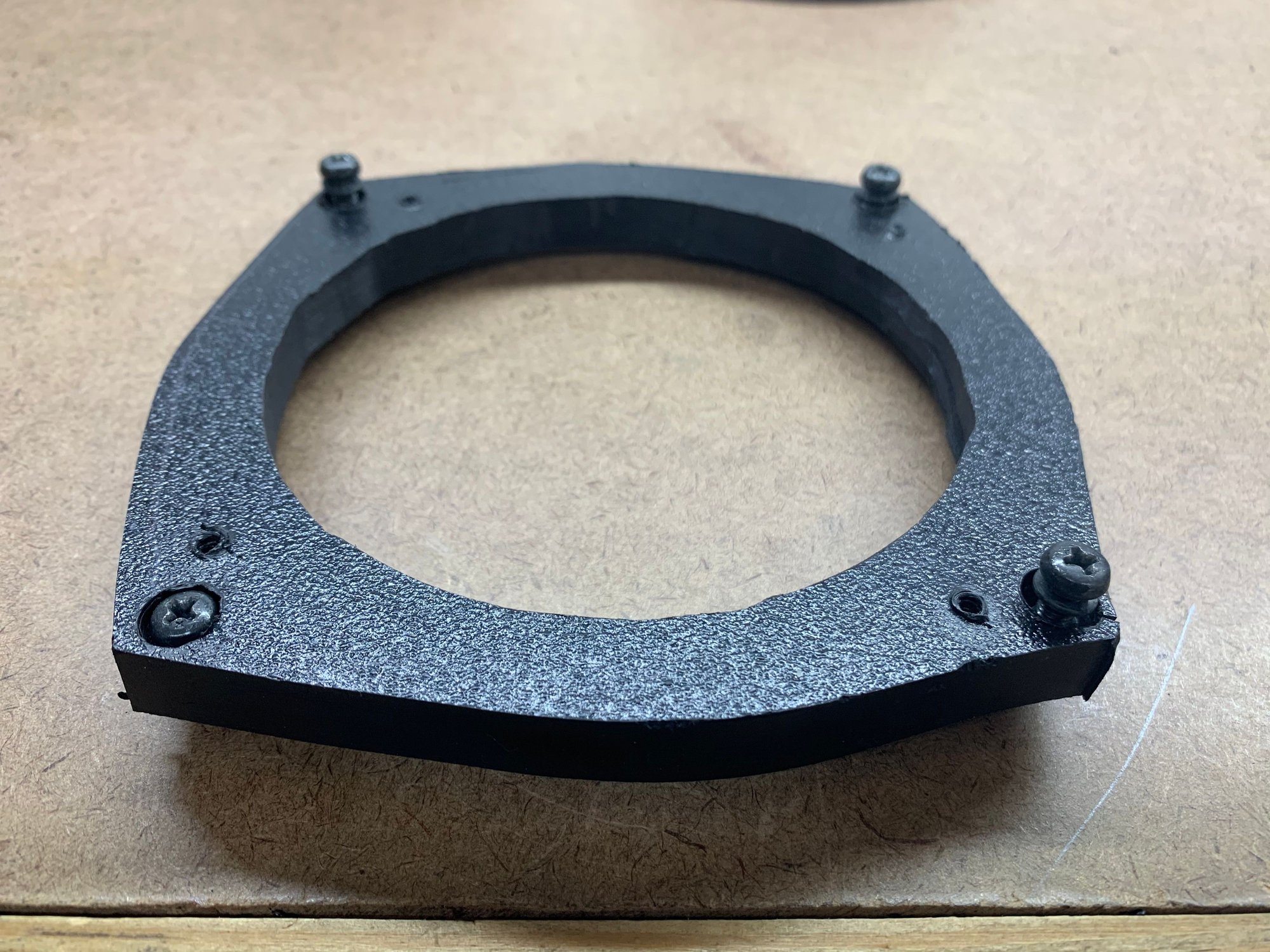

I got started this weekend, pulling out all of the old wiring, pulling the amp and crossovers, and test fitting and making adapters for the dash.
I have some more HDPE coming tomorrow and will lay out a panel to mount the amps and DSP in the left bag.
More to come...

For those wanting updates I made a template for the left bag and cut the HDPE to fit. Mounted the amps and DSP.
