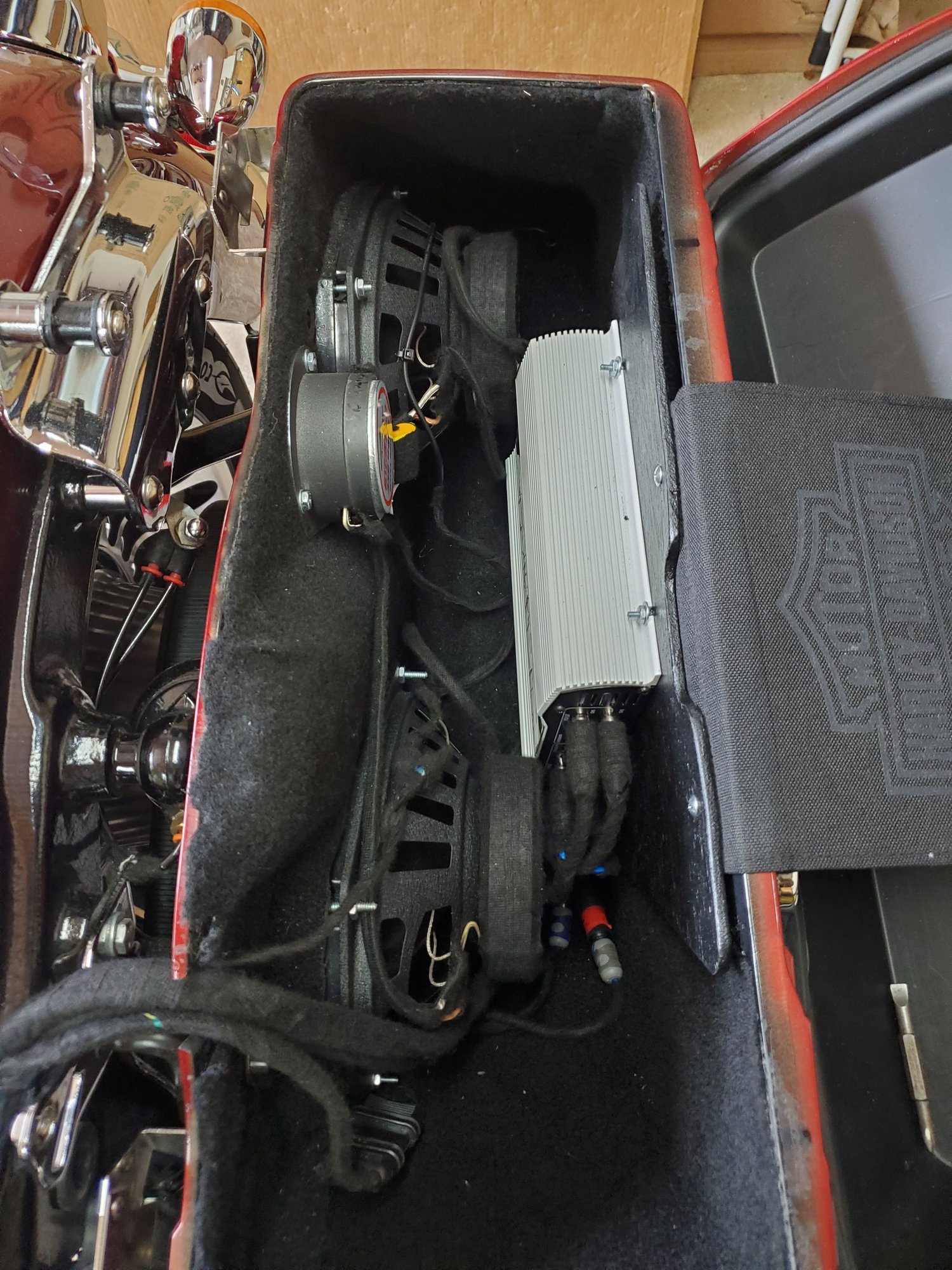

on my 09 UC that i installed sony me100bt,2 pair MBQUART fkb169 in bags, 2 pair mb quarts fsb216 6.5 1 in set in fairing and in lowers and 2 taramps 800x4 these mb quarts are 75 rms rating the amps don't have
varible HP setting just a fixed 90 hz i'm using the sony HP filter going out to amps i want to take more bass out of the fairing and lowers with out effecting the 6x9 in the bags 120 hz from the sony does a better job
to the fairing &lower but 6x9 has loss of bass. I know i will need to up grade speakers power handling for the amps .136 rms x 4@4 ohms to fairing &lowers and 200 rmsx4@2 ohms for 6x9's oh and the horn tweeters in the bags the system is loud and clear just want to get a little more out the system.

To use the equipment you have and get the sound you are after you will need to have better control of the frequencies.
I would suggest getting a DSP into play since the amps have fixed crossovers which will only get you close to your goal.
