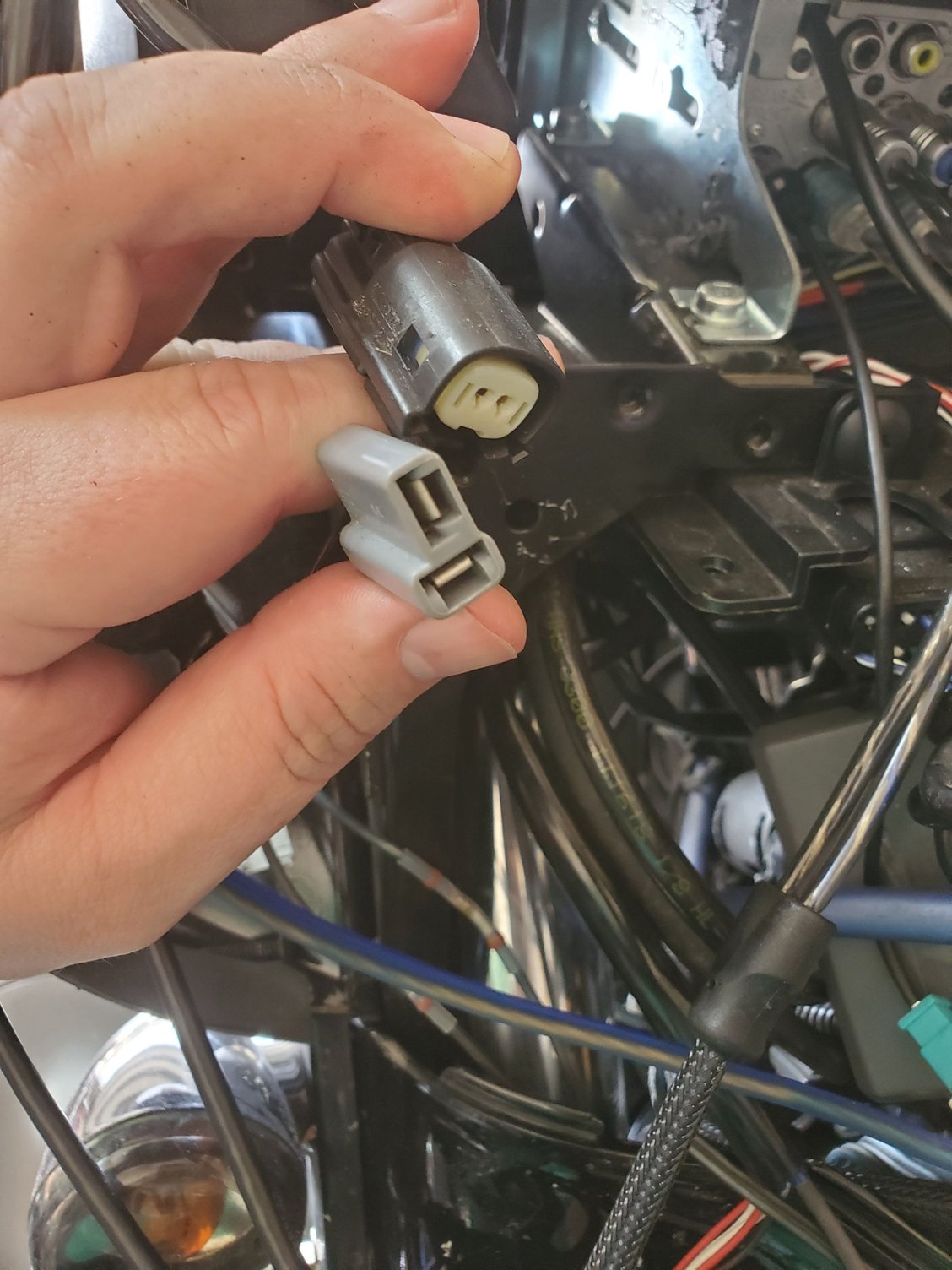

These are the only two obvious things that are unplugged

Ok, so here is what I did. I bought a 3.5mm to dual rca cable from Home Depot. I plugged it into my phone and the roads to channels 1&2 of the amp. Guess what...music, and loud music.
To me this means that by isolating the HU out of the formula, everything works. To me that means the HU is bad, or at least the pre outs.
Does anyone smarter than me (thats a lot of you folks) disagree with my backwards engineering?

makes sense to me. Does that hu have speaker wires output on it? If so you could hook a speaker directly to the hu to see if it has output on that side.
Is it possible there is something off in the hu? Does the hu seem to come on and function other than sound and usb issues?
