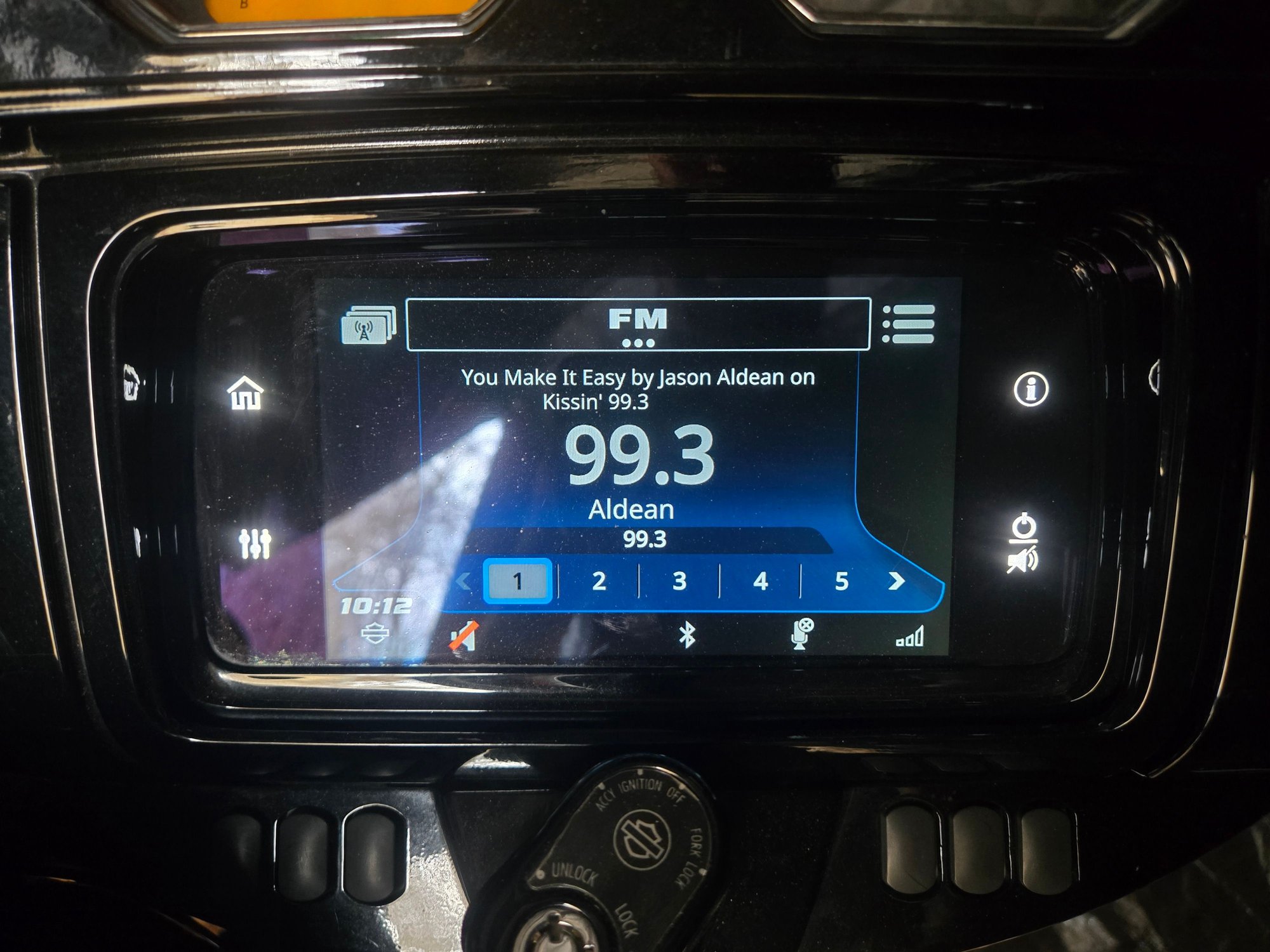

Default Sound system pics
Here are pics of the system
Old Mar 9, 2025 | 01:53 PM
cycle7447's Avatar
cycle7447
Community Influencer
Joined: Jan 2005
Posts: 5,861
Likes: 2,508
From: Lake Orion, MI
Thanks - you have the Boom Box GTS system which is standard for your bike.
Based on what you are telling me, I again agree that the issue is the reception from your phone. In other words, your phone is not getting a signal so it is not transmitting to your bike. I sometimes have that same problem when my bike is in the garage.
M y suggestion - take the bike to an area where you have a strong signal and see how that works.

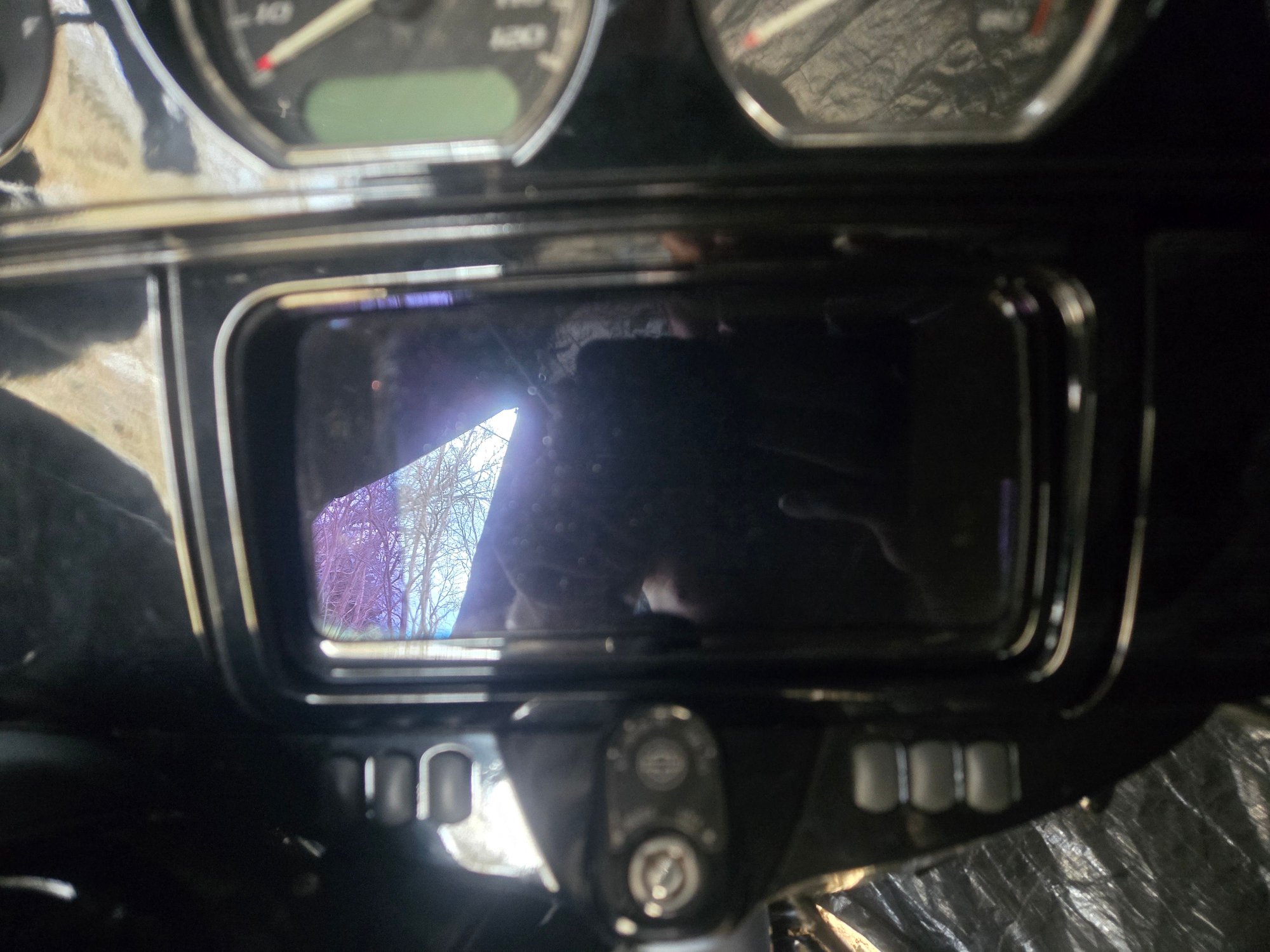

So I was out doing some work to my bike, cleaning jt, and making sure everything is tight and ready to ride next weekend but while doing that I had the bike connected to my phone and noticed it played just fine mostly on bluetooth and radio. But as soon as I would Crack it up within 30sec or less the sound would cut out then come back. So can someone please hell me, going riding next weekend and would love to be able to jam out going down the road. So someone anyone help me please... Also here is a pic of the inside of the fairing..
Old Mar 18, 2025 | 08:53 AM
Babyboy's Avatar
Babyboy
Joined: Aug 2014
Posts: 2,847
Likes: 574
From: Lockport Illinois
Now that we have more info about having aftermarket audio AFTER the headunit there are a few things to check.It is hard to tell by the picture.
On the input of the amp are there RCA cables?
If so :
Is there a line out converter between the headunit outputs and amp?
If there is no RCAs remove the SIGNAL INPUT plugs and measure the voltage while playing a 1k test tone at 3 bars down from full volume.
Report back with findings
