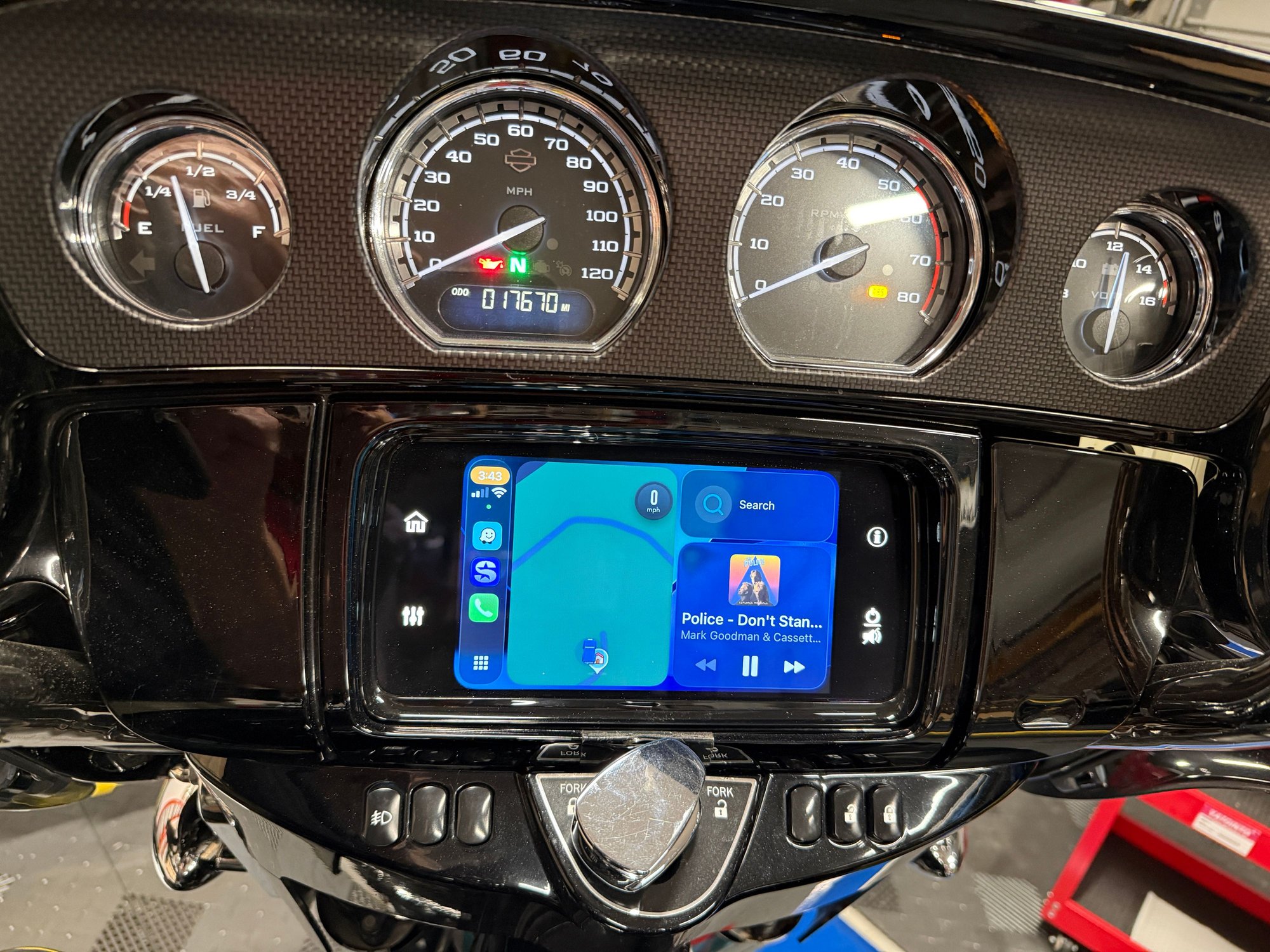

2015 CVO Limited currently with a Boom GT 6.5 and the J&M Rokker 800w 6 speaker kit installed by J&M (I think) by previous owner. The bike came from (then) Rossmeyer HD in Daytona and the installation looks professional. Probably not the system I would have picked but it's there and sounds good enough.
I bought a Boom GTS from a forum member that should be here in a couple of days. It was removed from a 2023 Tri-Glide.
Will the Boom GTS unit need a dealer flash for the aftermarket J&M system? I called J&M and they weren't sure. Who besides the dealer can flash the system if needed?
Thanks!

Installed it today and everything is working. The volume is extremely high at the half way setting.
