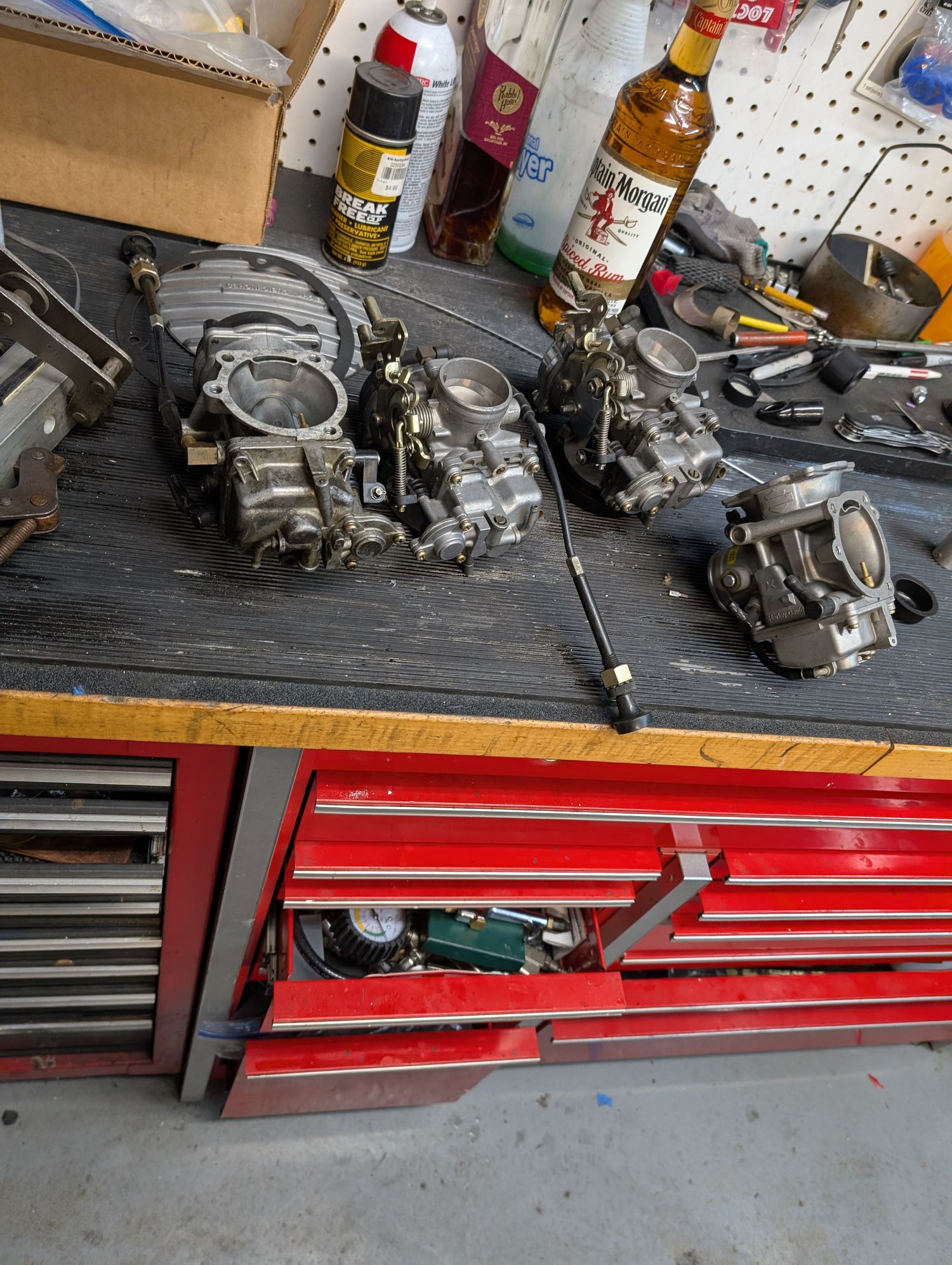

Just letting everyone know, that this carburetor came off a 1999 Softail Springer, beautiful bike.. Wish I took a Pic of it..
Anyways, the bike ran flawlessly.. With the condition of the slide, it had no effect on performance.. My friend is very happy.. Thanks for all the help..

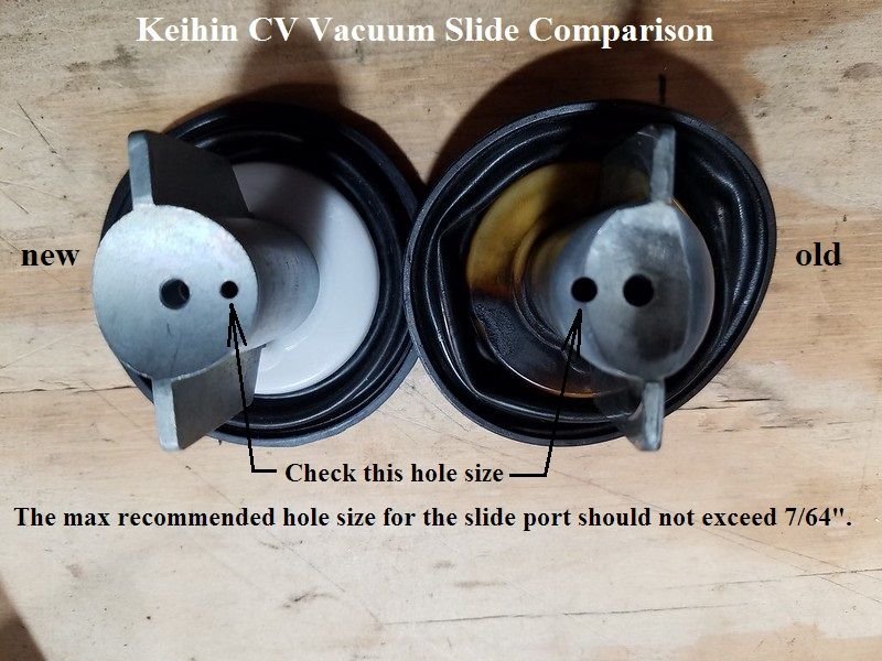

Hey, 1999 Springer Softail original carburetor, 80 cubic inch Evo.. I've never seen this type of issue with the slide on a CV carburetor where the retainer for the diaphragm appears to be overheated and warped. Is there the possibility that this will affect the seal on the diaphragm and is this guy going to need a new slide because that part is not serviceable? You'll see the difference in the gaps in the picture that I posted.. The Gap all the way on the inside though seems to be pretty even, it's just the outer edge that supports the rest of the diaphragm.. Thanks...
Heat warped, the slide rails are probably worn and your getting the pulse flutter too, hate saying this but those $12 chicom kits off amazon work pretty well. I have a bunch of CV's I've been reviving and slapping on the shovels, tried a couple of the kits and so far no issues and for the price it was a cheap experiment that paid off.
Just run the sticker number on the carb for the right one.

Originally Posted by Chris_G
There's a performance tuners kit where drilling out that port is part of the process, even supplies the bit. Won't work without the new emulsion tube and jets that come with. Played with a few of those with mixed results and I have found a few carbs that must of had the kit at one point and somebody pulled everything but the modified slide.
