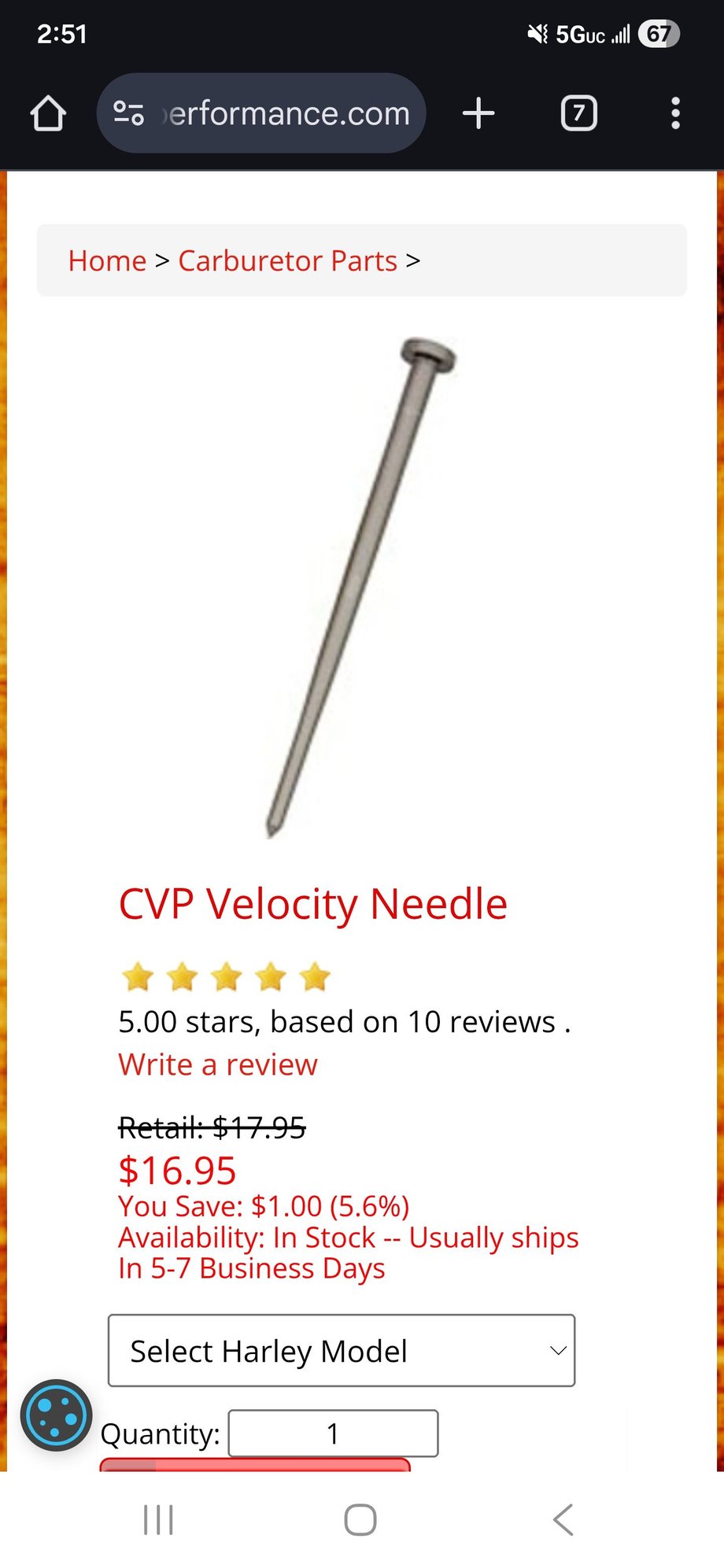

When you say sportster style needle what do you see that makes you say that?

I ordered this needle from CV Performance.  It appears to be the exact same needle as the one in the carburetor already,  so I did not change it out.  I may have mispoke when i said the Sportster style needle, however I am under the impression this needle from CV Performance is the '88 Sportster style needle. I could totally be wrong.

CV performance do make a copy of the "sportster" needle, they also make the one you pictured there, I'm not trying to corner you, just trying to work out what you have, CV performance don't advocate for the slide port to be drilled out either so I'm wondering what other little "enhancements" have been done by the previous owner.
Edit, Also the 46 idle jet is a CV performance item.

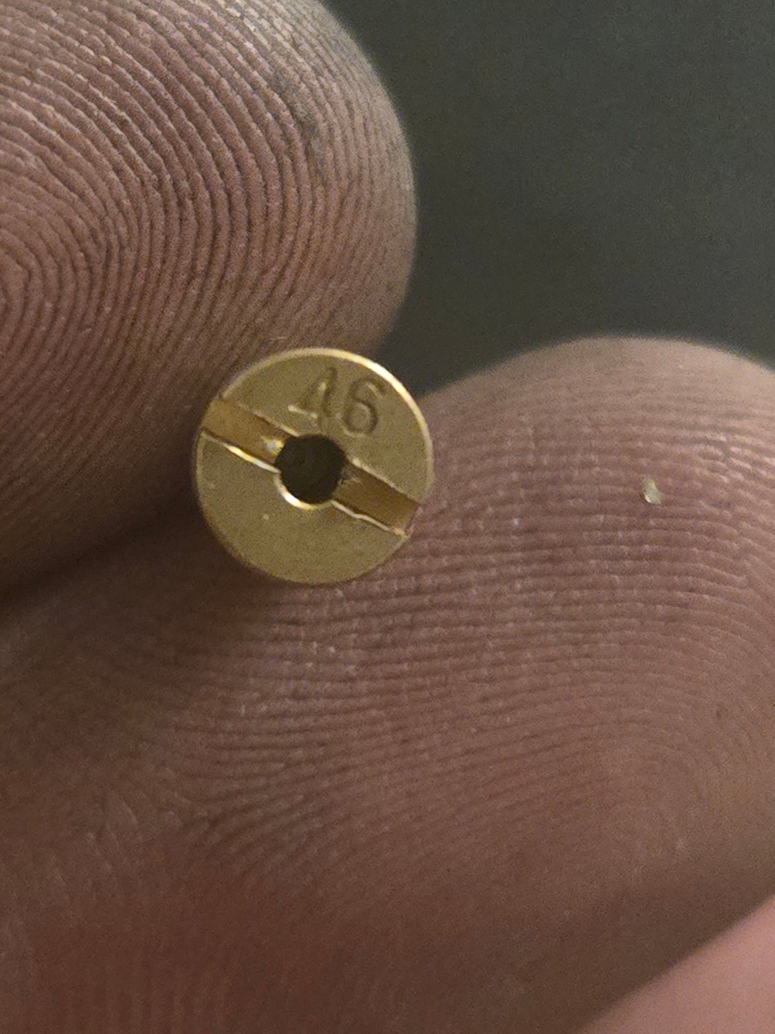

Main jet currently in it.
Pilot jet currently in it.
Previous owner had these installed. I took these pics so I didnt forget what sizes are in there. After cleaning them, I re-installed them. On my next days off from work, I'll provide a Pic of the spark plugs, seems to be running a little lean which is why I was thinking to upsize the main jet. Carb tuning is new to me, Im just going off of what I read in the manual, here, and other sources....
