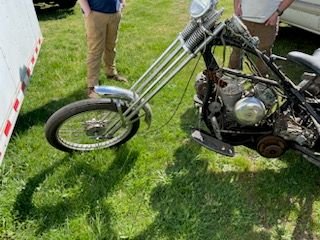

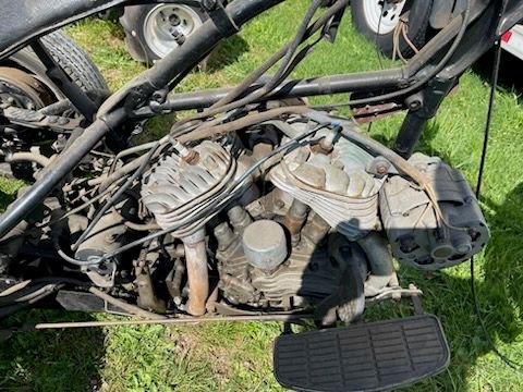

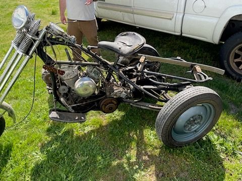

Default Meter reader trike AMF era
Saw a mid 70's trike that's pretty rough.
Guy said it was used as a meter reader vehicle.
Most of the parts are there. Tank, hub caps, original front end.
Foot clutch
Guy said the tranny is geared low and slow.
Anybody know about this.
I've not seen one

Yeah, low and slow pretty much sums up a 45 in stock trim, specially dragging a third wheel around. So don't expect to be highway cruising on it. 45mph more like it.
But they are a fun old bike. That one looks like pretty late model with the alternator and electric start. First two digits of the engine number should give you the year. I think they ran as late as about 73 or so. Kind of a living fossil running a flathead several decades after the rest of the world gave them up.
You can still get lots of NOS parts for the engine and trans, although not as many as a few years ago, so can be a good project if the price is right.

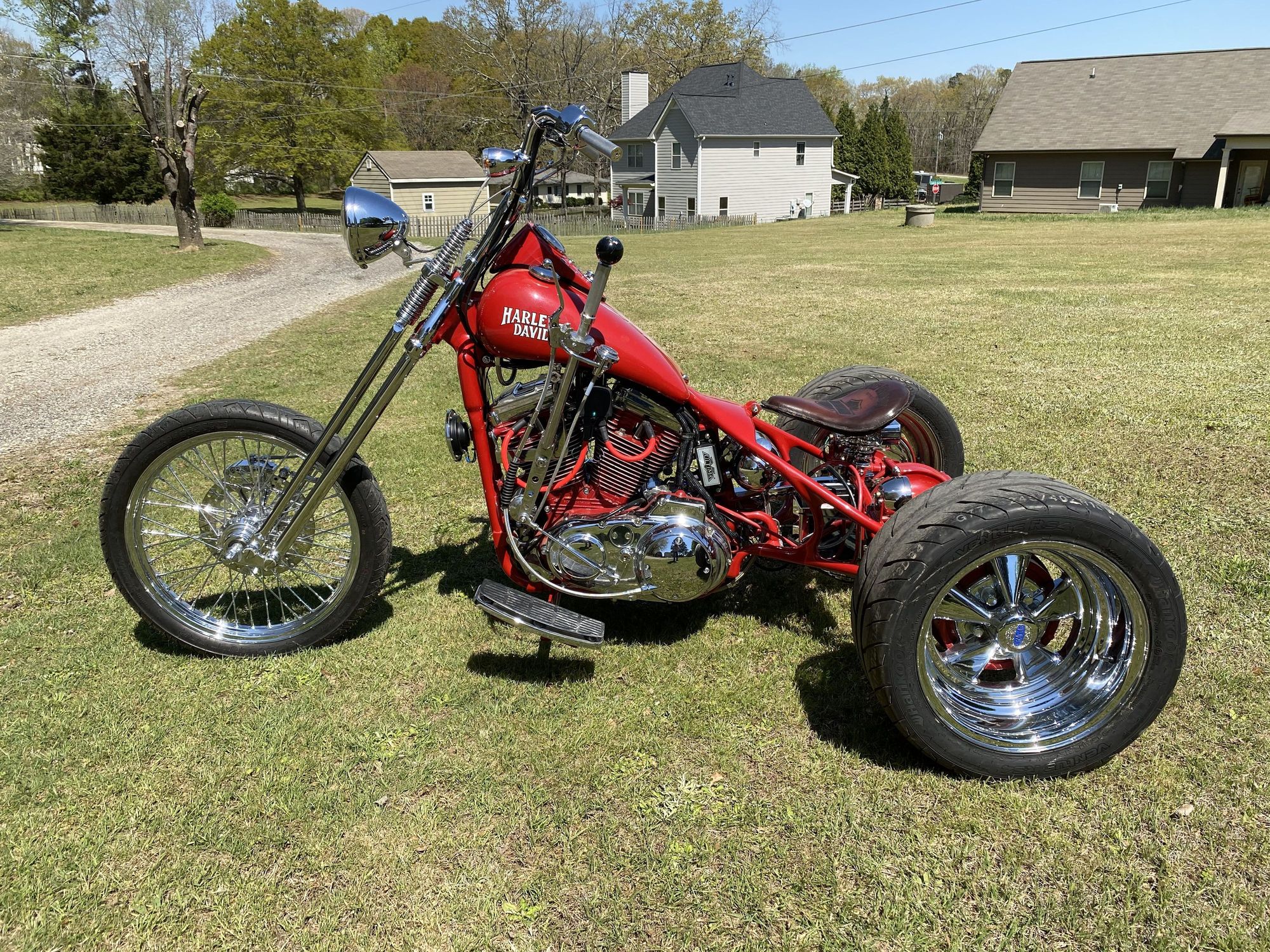

Wonder how long that old Servi-car diff, designed to take the 45's 28-horsepower, will last with that Evo Sporty engine pumping through it? Although, knowing Harley of that era, the diff is probably so over-engineered it will take it.

Harley Davidson Servicar, built until 1973.
Mechanically it looks complete, but the front end is after market and of course all of the body work is missing. Not sure if the VIN # on the motor starts with the model year after 1970, should follow the factory method, so the last two would give us the year. Unless it is 1969 or older, than yeh left side of the motor under the carb is the VIN#.
Current market price, with paper work and running, maybe $5k. Going to cost to get her back to stock, even the later fiberglass boxes go for over $1k. Maybe you could sell the front end to a Chopper Kid for some return on your investment. For me, I would look for an older one with the metal box, no alternator and electric start. They are just answers looking for a question.
