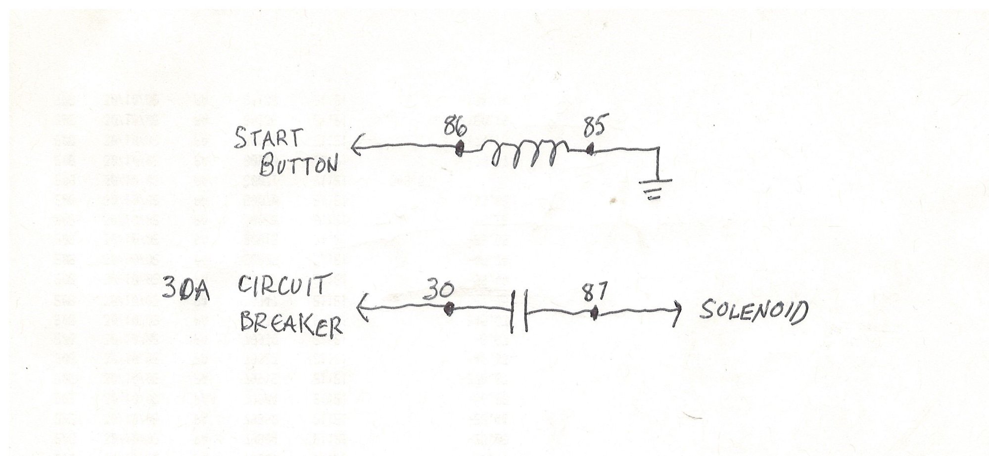

If you want to get it going you are going to have to add a Starter Relay and mount it securely (I recommend the Bosch type) . Find the wire from the handlebar start button and wire to this diagram.
I think it a rather stupid design to make the relays in that assembly nonremovable.
