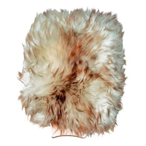

Use 2 buckets and 2 or 3 wash mitts. 1st bucket, soapy water. 2nd bucket, warm rinse water.
Yepper the TBM and a Wookies fist.
