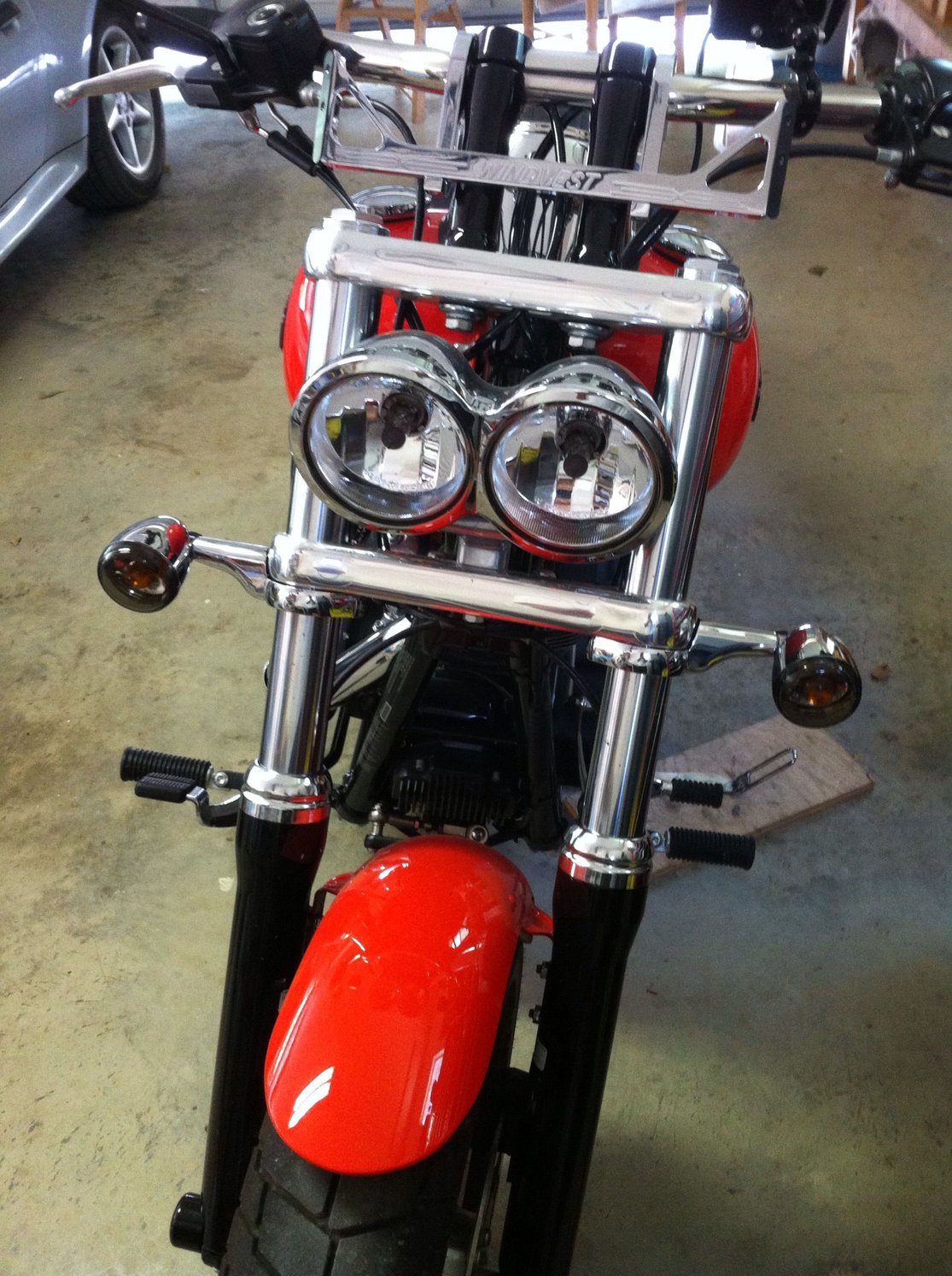

I just used the standard HD relocation kit but others have used different aftermarket kits and turn signals that are smaller:

How are the wires routed?

HD is on top of this mod! They provide a extra set of connectors in the wire bundle underneath your fuel tank. You basically end up snipping the signals off your bars and using kit provided wires, you rewire the turn signals and plug into the extra connectors under the tank.
