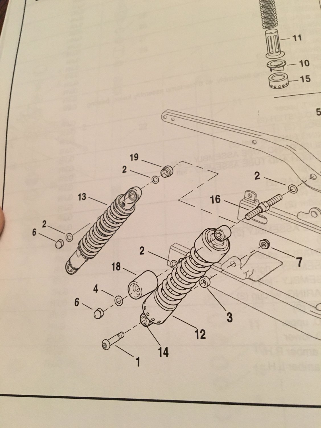

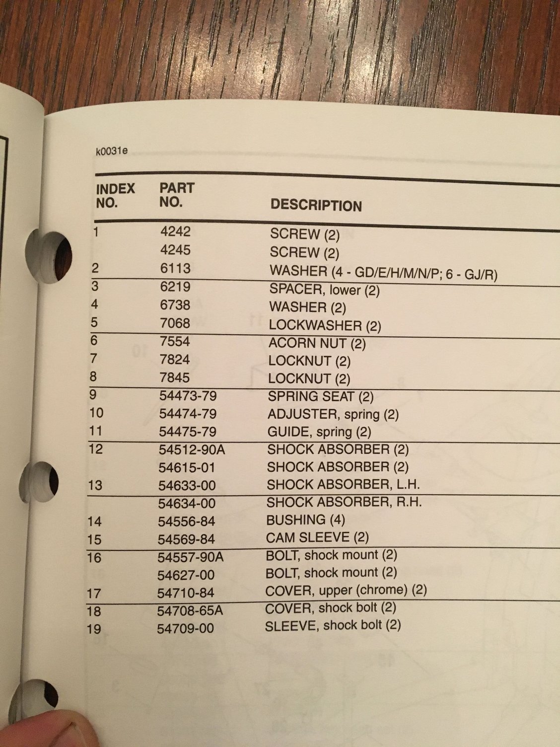

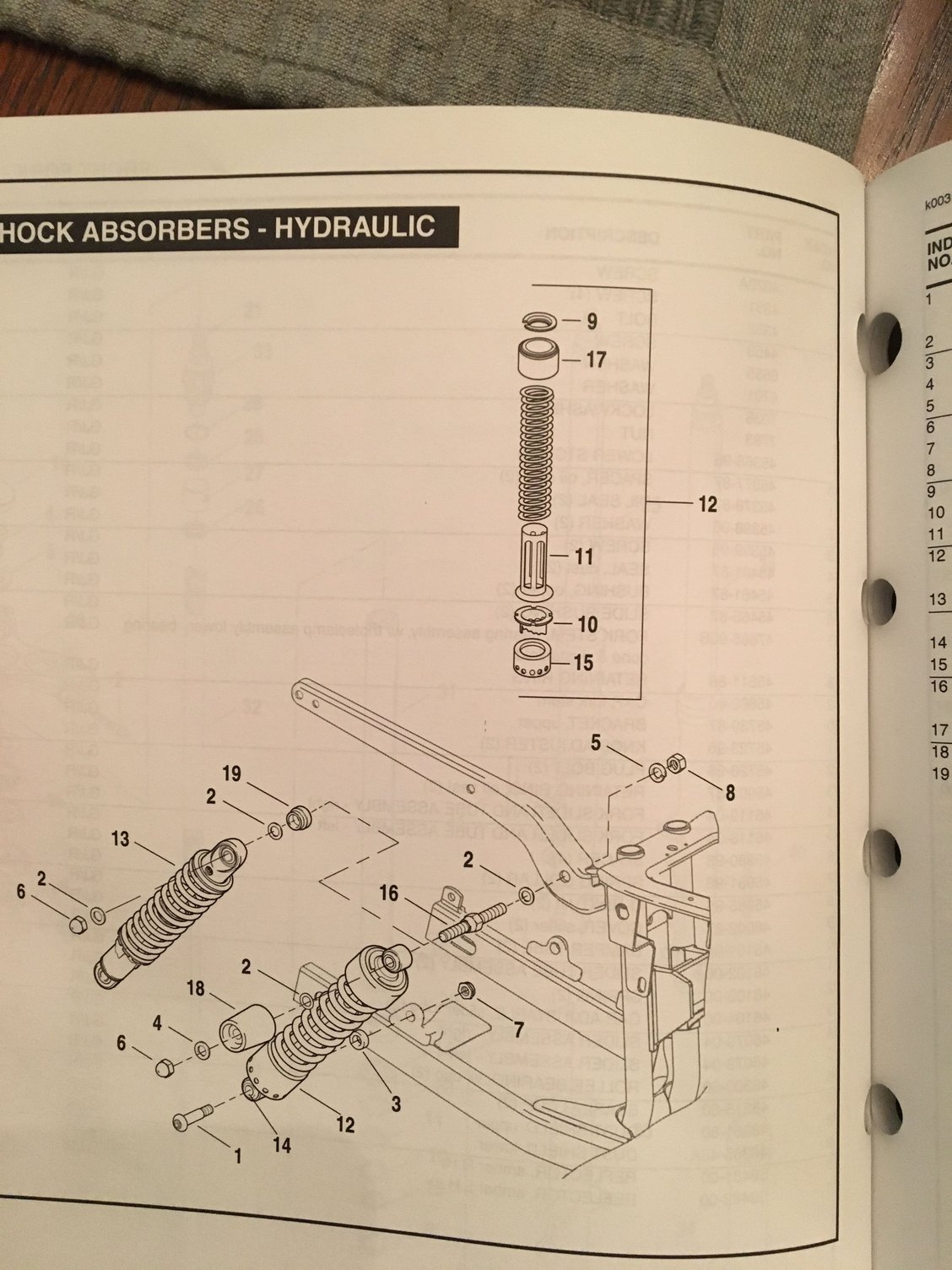

Old Oct 25, 2015 | 10:42 AM
cm1101's Avatar
cm1101
Posts: 24
From: Atlanta, GA
Default Try these-
