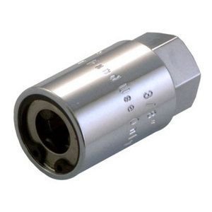

Penetrating oil and a stud remover might work.
Kids these days with their fancy specialty tools.

How does that tool work???
Kind of like a Chinese finger trap except with a twisting motion.
There are probably three spring loaded knurled bars that have an off center pivot and get closer together when the whole thing is twisted counterclockwise.
That is my guess.
