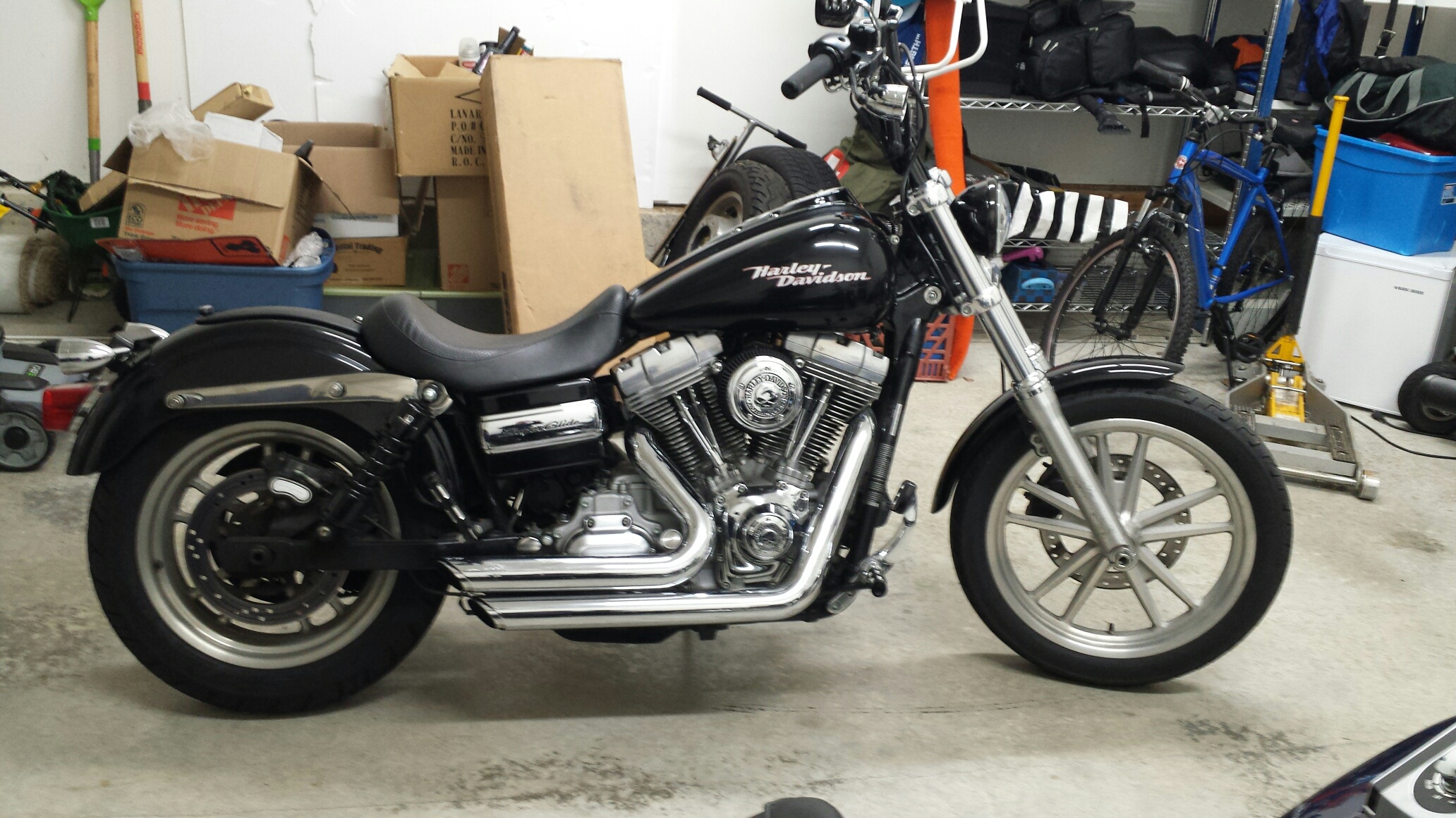

unless he did the sequence of button pushing. but he loves the bike. it had just under 19,000 miles. i sold it to him for 6k. here is some pics so you can see he got a good deal.
