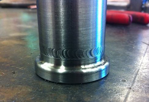

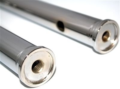

Measure the WCTB base...
These "Fat" 2" Risers are 1.5" OD...If that's same or larger than the bars...use them
http://www.dkcustomproducts.com/2-In...2-SFT-RSRS.htm
EDIT:
Is this what your bases look like?
That's probably why they want you to use theirs...the recess
So for sure the diameter is more critical...same or larger OD riser ext
