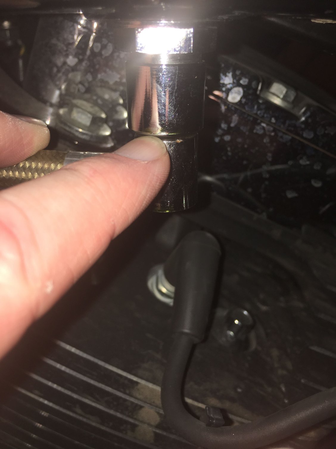

Its leaking from between the joint of the piece that screws into tank and the piece the line comes out of

Just my guess or theory why it runs few seconds would be fuel fills the line, when you start engine it sucks air into line from the joint where the leak is, when that air hits the engine (injectors) it stalls. When engine is off fuel runs back into line, a little leaks out at the joint, when you start engine again it sucks air into line again at that joint, ad infinum.

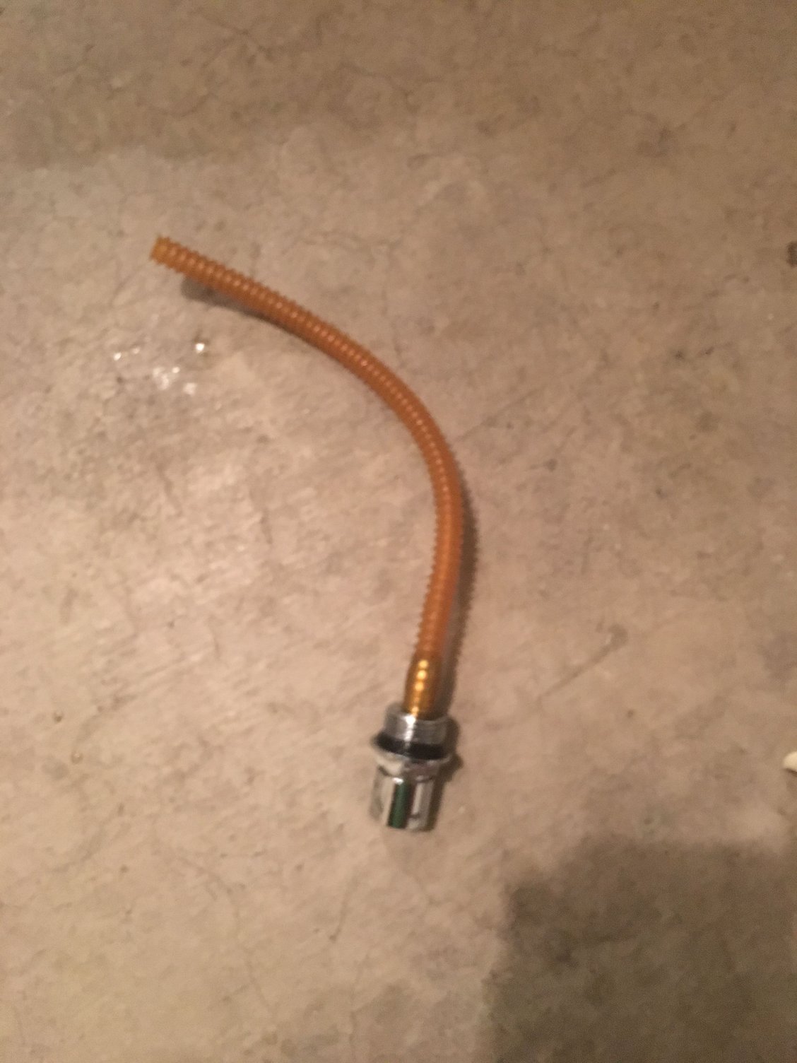

That sounds plausible. I was able to get the quick disconnect apart. The upper part that Is supposed to slide up was jammed up and was just leaking once disconnected couldnt get is to stop so i pulled it out. The slide part sounded crunchy like u put rocks in a blender.
Hers is what came out
Now i dont know for sure but im gusseing that when i go to replace this piece im gonna have to open the tank to plug the line back in yes?

Yep, the open end of that hose connects to the output of your in tank fuel pump. Since its FI, it's a high pressure pump, so I'm not sure that the end just slips on, I would expect a clamp or fitting. The manual should show it.

Just looked at my service manual (2016 - so may be differences) and it appears that there is a connector on the open end of that fuel hose... Did you cut anything? I guess if you're replacing the fitting anyway, it'll come complete.

No didnt cut anything but i think the line broke haven't opened the tank to find out
