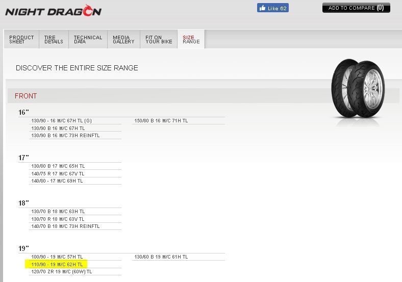

http://www.pirelli.com/tire/us/en/mo...ht_dragon.html

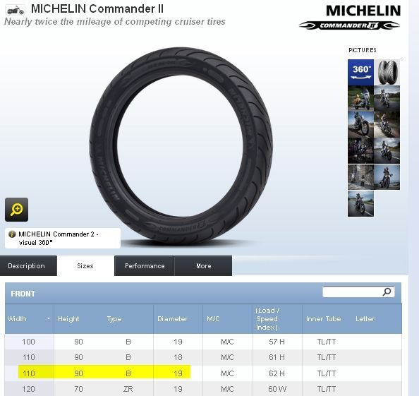

Another ...
http://motorcycle.michelinman.com/tires/michelin-commander-ii#dim
