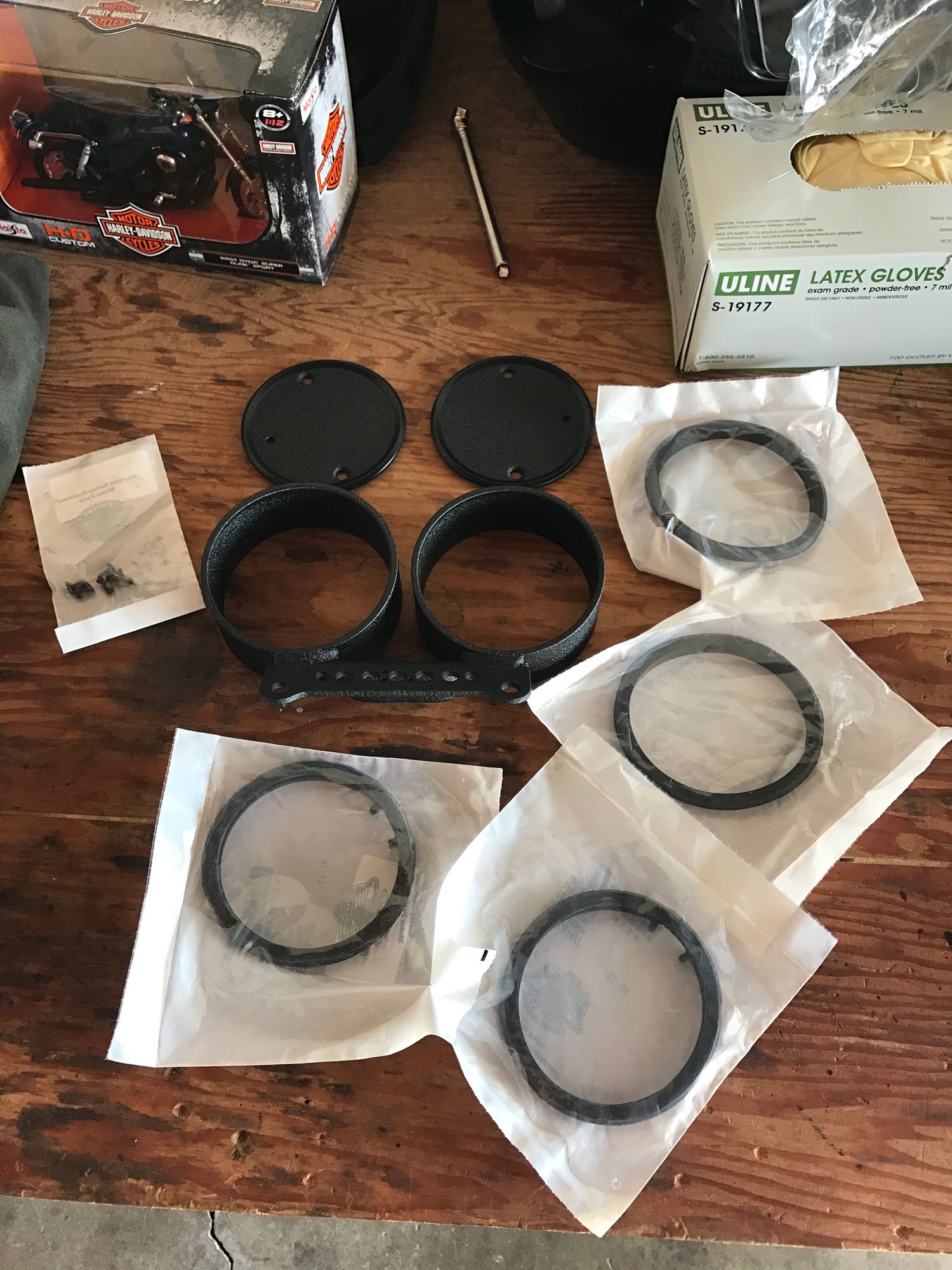

A few more goodies for those still interested. Picked up some essentials to mount the gauges on the bars. Here is the part numbers, they've been listed before but Im posting them again in this thread. The total for this was $168.47 new from HD. Luckily, none of these are obsolete...yet.
2361 x1 - screws to hold the back plate to the gauges (they come in a pack of 5)
67319-95 x2 - tach cover without the button hole
67344-97 x2 - rear rubber grommet
63745-97 x2 - front rubber grommet
67338-97 x1 - tach/speedo mount
I have yet to get a harness, I think Im going to save myself the hassle and buy the Big Bear Choppers harness for $100. I have to buy a gauge mount bracket too since I have the one piece Lucky Daves bars going on. Ill probably pick up an Accutronix mount. LA Choppers makes one for about half the price of Accutronix so I may go with that instead. I still have to work out the issue of filling the holes in the dash. Haven't gotten that far yet, but back in the day I fiddled around with kydex and gun holsters so I may whip something up out of some .090 black Kydex. Or Ill get two more gauge back plates and use those for the time being until I get something fancy going.
Also, the bike is being torn apart this next week and going to get fixed and painted, some parts powder coated, and installed so progress will continue on my, I hate to use the term "build", and things will get rolling. I don't consider it a build but "the action of bolting on parts other than stock" is well under way haha
Are you sure our gauges will fit in there. i thought the newer dynas had a larger diameter gauge than the old dynas??? I will trust you, I'm just trying to clarify, did you actually fit the gauges into the mounts yet?
How did I not see this!! Would have helped in my searching last night. I ordered the same last night but got the back cover with the button hole for the speedo. Just emailed boardtracker to change and get 2 of 67319-95. Glad I saw this!
