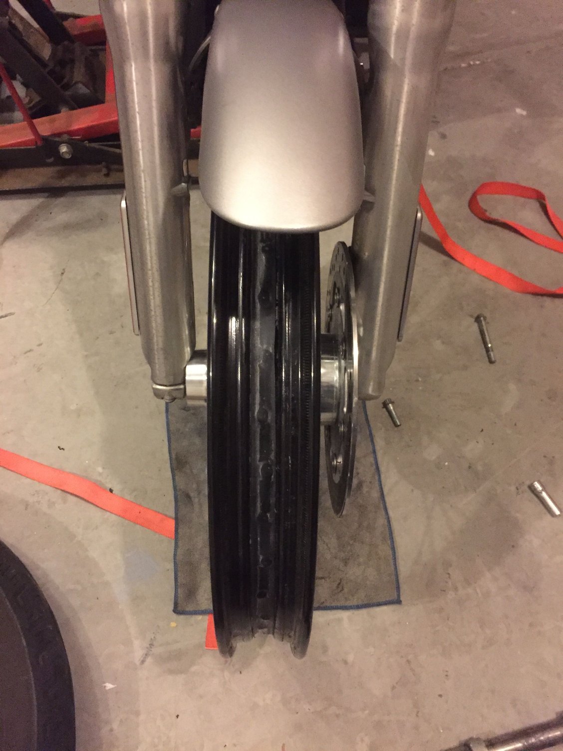

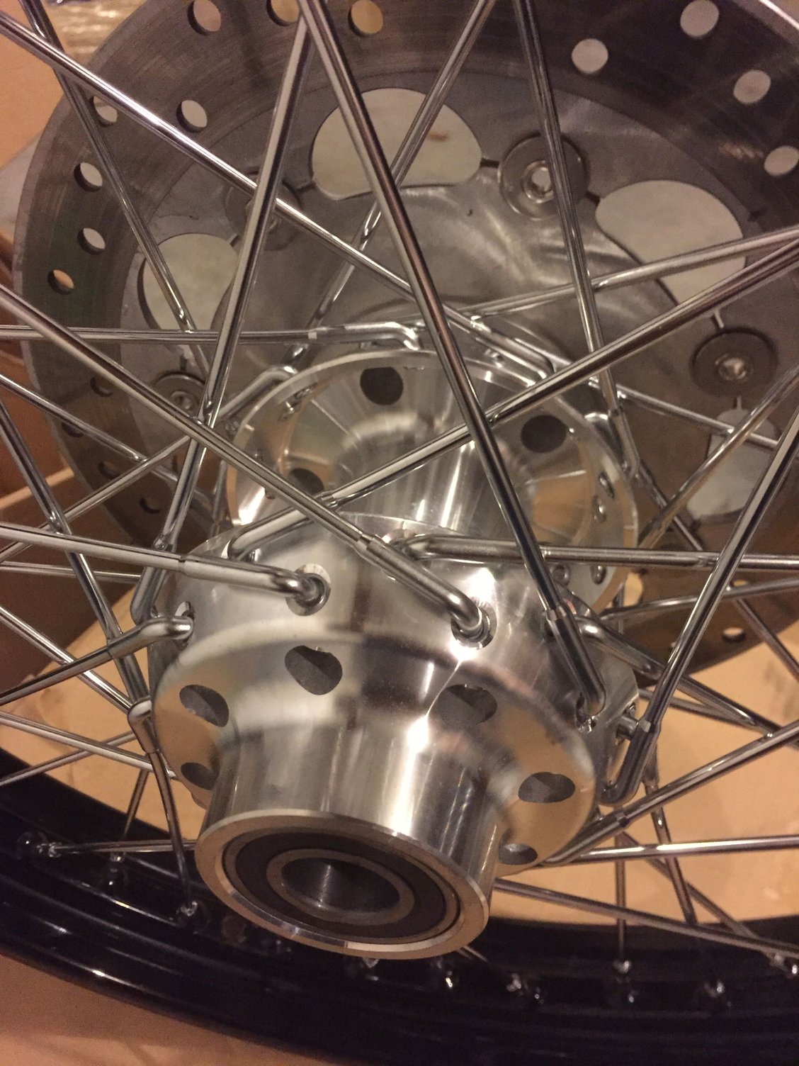

Picked up brand new wheels on Craigslist for my dyna. Came in box. I anticipated having to change the bearings if needed but the front wheel hub does not work with my front end. After a little research I believe it's for a wide glide front end. My question, what's the best/cheapest way to remedy my problem? Swap hubs, buy a whole different wheel?

Post a picture of the hub from a different angle.
Is it a 21" rim? If so, I'd say you're correct on the Wide Glide guess.
Could swap to Fat Bob or Wide Glide trees, or buy a different wheel.

Too bad you didn't ask first, but unfortunately you didn't know there was anything to ask

Yep, that's definitely a Wide Glide hub.

You just need a stock fxd hub.

and spokes then

Or fat bob trees, axle and spacers an somehow mount the fender.

The most cost effective option for you at this point is to sell that wheel and buy a new one with the correct hub for your setup.
