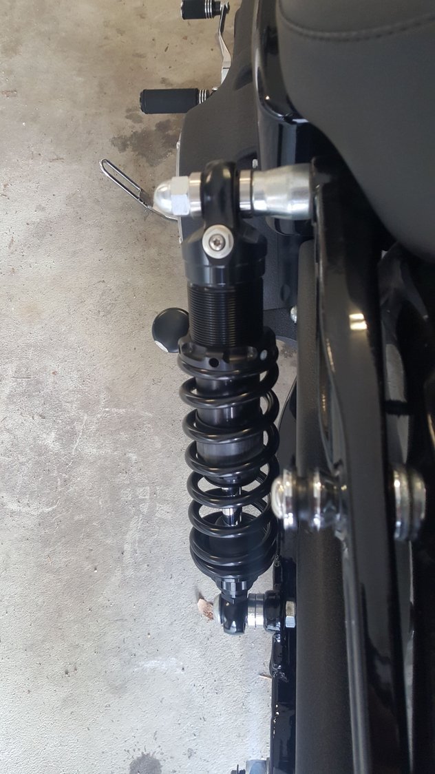

Old Aug 29, 2017 | 08:19 PM
bigbadpoppa's Avatar
bigbadpoppa
Joined: Sep 2015
Posts: 1,020
Likes: 130
From: Vancouver
Spacer setup
