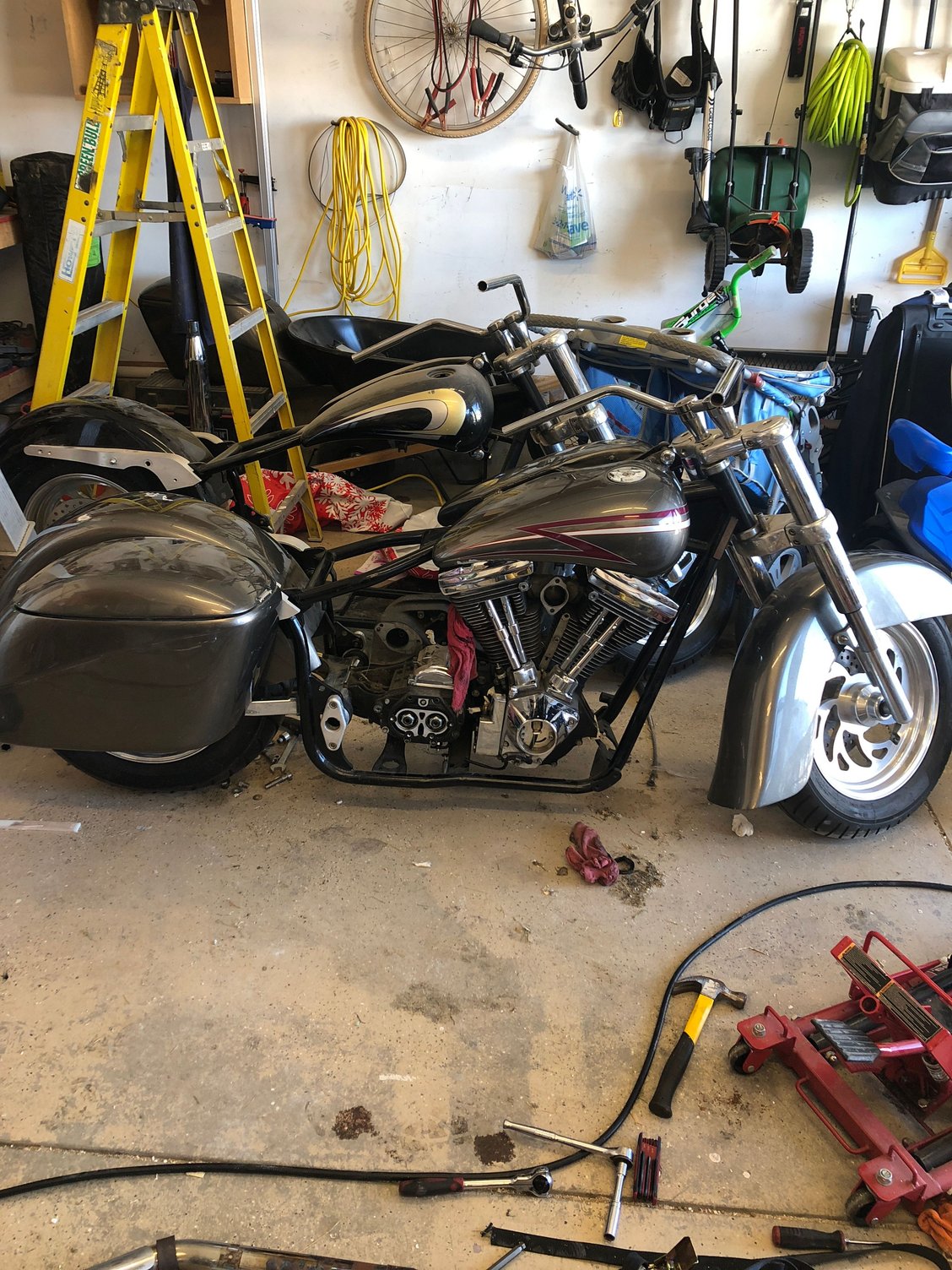

Forgive my mindless question, but I picked up 2 American Quantum Cycles that we’re never completed prior to their bankruptcy. I am assembling 1 and probably part with the other. My question is, what do I have here for a frame style ? I’m finding Dynas parts that fit and softail parts that fit. I will attach a couple pictures of what I have. I’m thinking the engine is possibly a twin cam A but could be wrong. Thank you for any helpful information.

Evo pattern engine.
The frames aren't Dyna OR Softail.

Engine for sure is an Evo ... frames look to be FLH style

I didn’t realize they made the evo that the trans bolted to the engine. Thank you for clearing things up a bit. Getting it put together

Would I look for a flh style evo exhaust do you think ?
