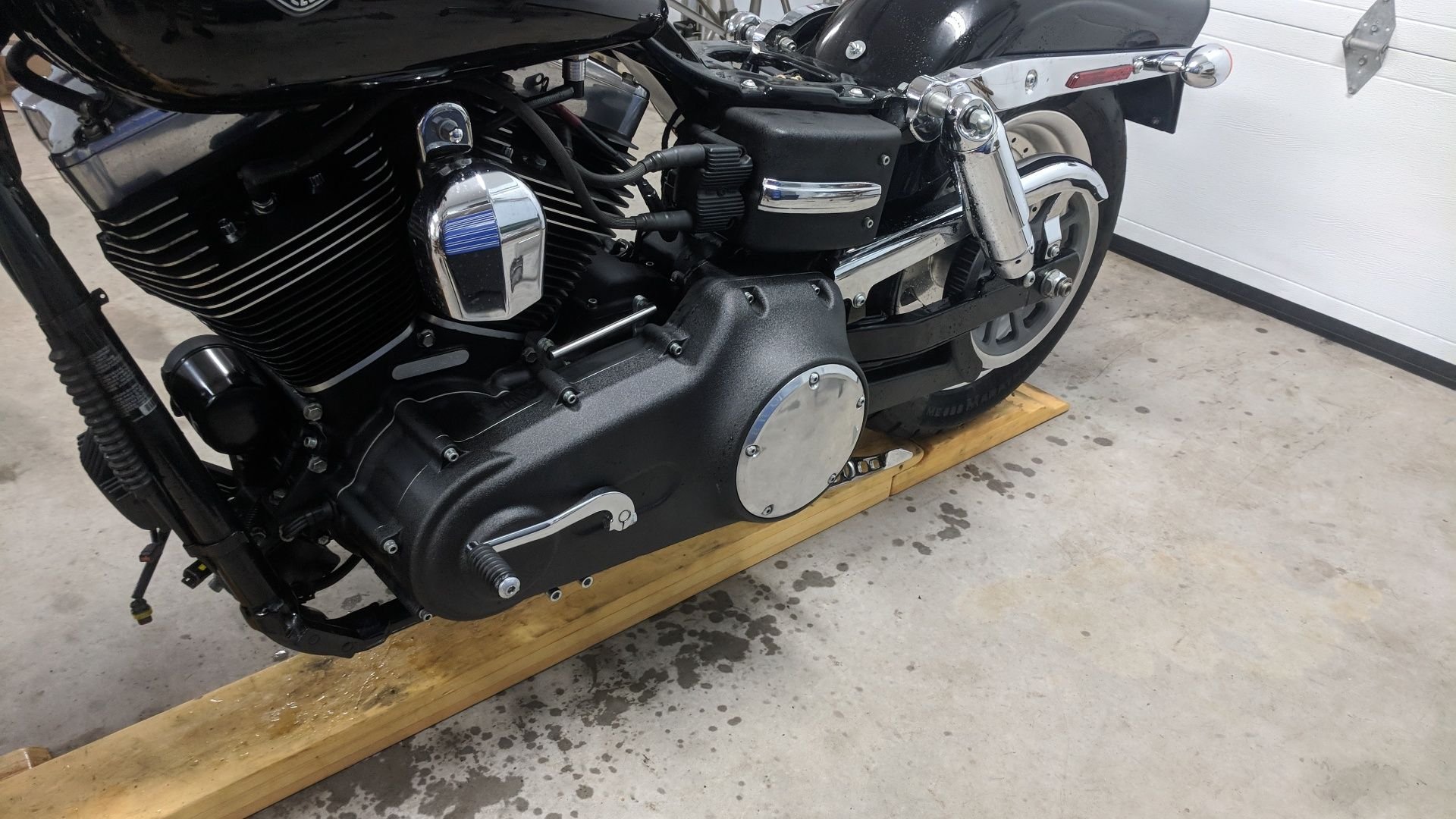

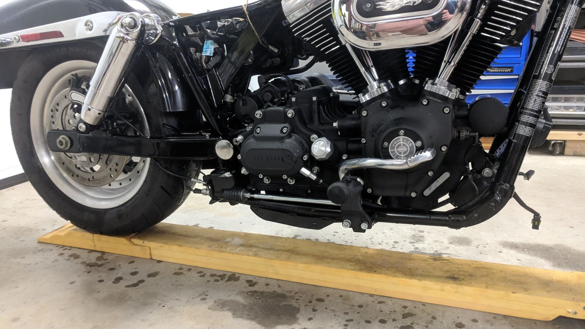

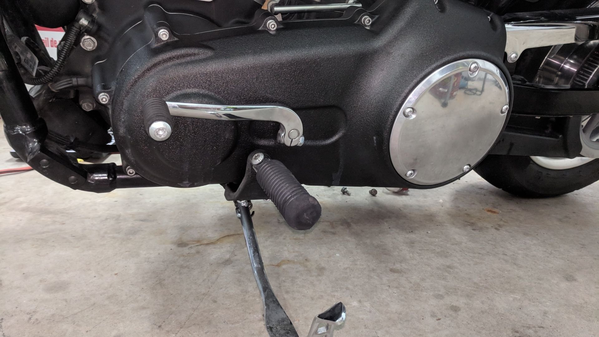

Foot Controls

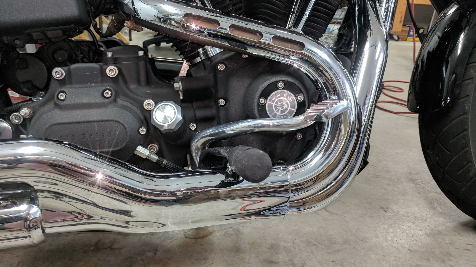

Mid controls are installed. Only got to try them for one full day, and I love them, even while being cramped as I was. That'll get better with other changes so I'm not worried (yet). I rounded over the ends of the rubber footpeg covers to make it slightly easier to get my boot onto it. Olfa blade followed by twisted wire wheel for shaping and texture.
I ordered the further forward mid set from Harley. Does anyone know if there is fitment problems with the exhaust pipe in this combination? I've seen other bikes have the tommygun headers so does anyone have that plus further forwards? The pedal touches at full travel as it is, and if the new one is just 2" straight forward it won't even fit. Possible solution would be to get the part number for the pedal and get a second-hand one, and shave off that corner. I don't know if how that part is cast would allow that or not. A better solution would be a new exhaust. I've been wanting to get the Lowbrow Customs 2 into 1 SuperMeg for a while now, and I'm wondering if that will work.
Seat
Saddlmen Step-Up in Tuck and Roll is in transit somewhere on its way.
Handlebars
At this stage, I'm hoping that the changes to the pegs, seat, and shocks will allow me to use my current setup for now. It's the stock bars on 2" riser extensions. I really like the look of the Zombi bars and will see about those maybe next year.
Shocks
Today I ordered a set of Bitubo Twin Adjustable Performance Rear Shocks from DK Custom Products. LINK HERE
I originally wanted 14" but the longest these go is 13".
2011 FXDF with mid-controls. Outter primary case is new OEM.
2011 FXDF with mid controls. Stock head pipes, V&H slipons.

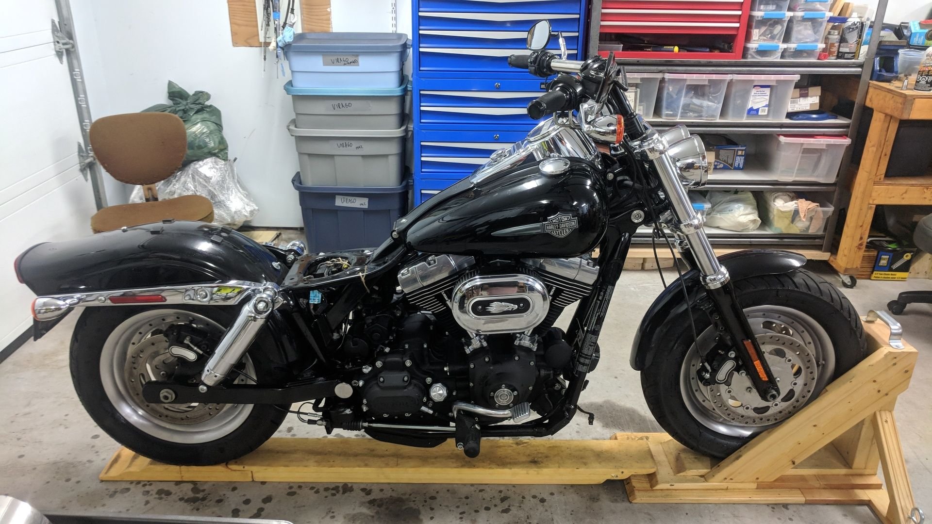

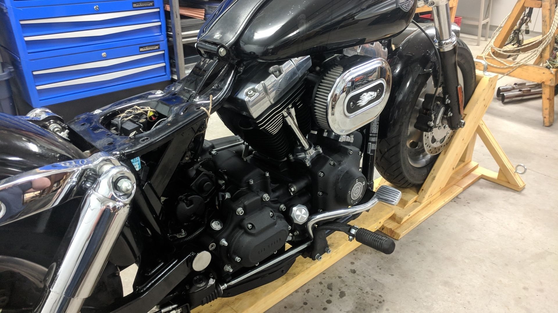

The exhaust arrived very quickly, and the footpegs arrived on Friday so I started to remove the stock exhaust. I got the exhaust stripped off yesterday. Today I started by plugging the exhaust ports and degreasing the engine. I used excessive amounts of WD-40 to clean and rinse the grime from the engine. I used brushes and wooden picks to scrub and a rage to wipe as much as I could off. I used some Windex next because I read somewhere here that it was good for the wrinkle black, but it likely could've been skipped. Next I used hot water with dish soap to rinse, using the rag to mop as much water as I could up onto the engine. I rinsed it off and did the wheels while I was at it. The pictures are from when I pulled it in, but before I dried it. The wood is my to not having to buy a new style of jack for this bike.
