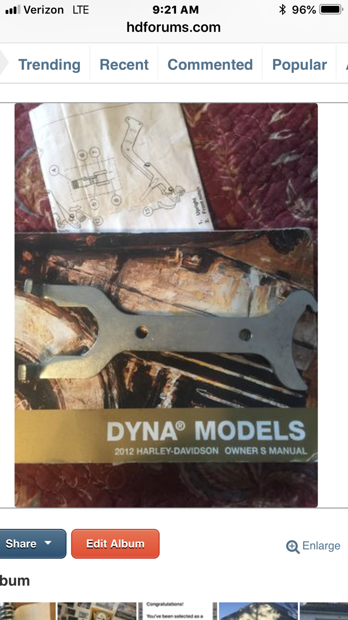

spanner wrench, bolth sides should be equal.

I know my stock shocks that have the holes in bottom require a spanner wrench. If they are ones like the pick I posted they are hand adjustable and go by clicks. If yours has the holes and uncertain if they are on the same setting you can reset them. For instance I wanted to stiffen mine and after 3 clicks using the spanner wrench the preload went back to the softest setting and you will know that’s what happened instead of a click it was more of a slam of sorts. When that happens on both sides now they are both even and you can start all over.
when I first bought the scoot A buddy of mine who is a former Harley mechanic just looked at the shocks and said they were on the softest setting. Not sure what he was looking at but he was right. After a ride with the lady I knew I needed to get out the spanner and stiffen em up.

Yeah, I mean, my Sportster you can see the setting, on the Dyna, its under the chrome flange with the holes.
