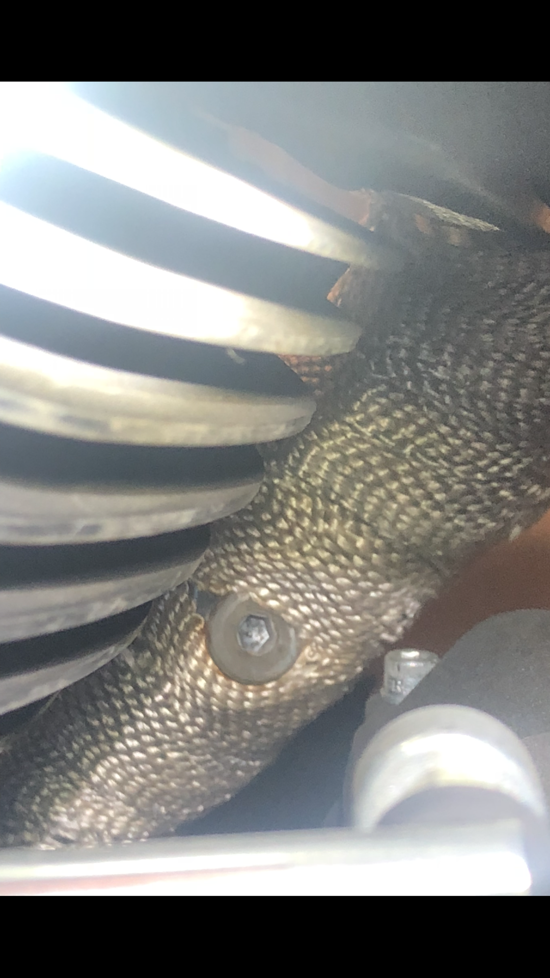

Old May 5, 2019 | 11:12 AM
Durham man's Avatar
Durham man
Joined: Mar 2017
Posts: 3,326
Likes: 1,889
They look like this. This is my 2012 wg. Confused yet. They are also for when you bypass the 02.
