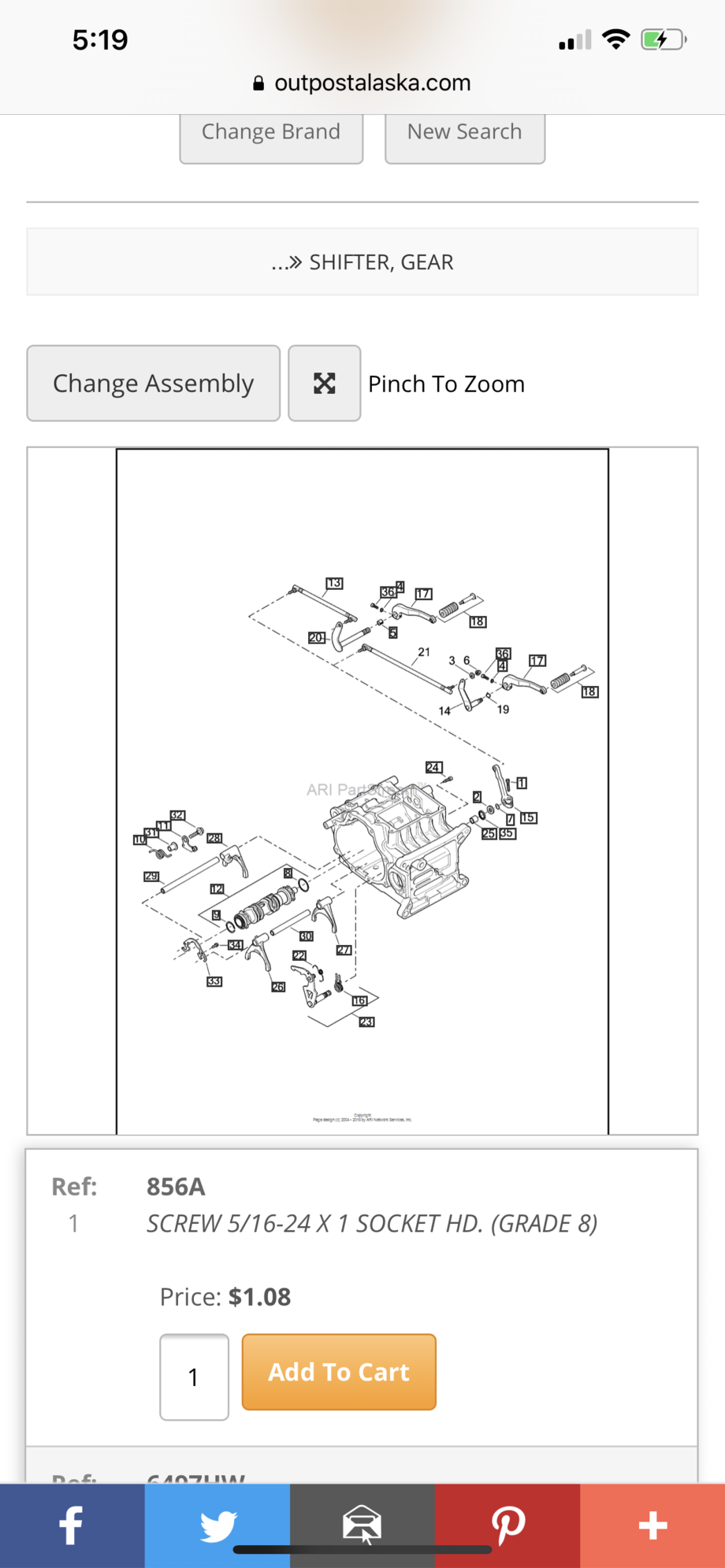

The thing I don’t get is when I look up the part Diagram for a 14’ or 07’ for the gear shifter. It shows regardless of forwards or mids that lever doesn’t change. The dashed line in this picture goes to either.

The way I read it is that the diagram is showing both options for forwards and mids from the rod onwards, but doesn't show two different 'LEVER, shifter rod' parts in the illustration. However, the table lists it as having two different part numbers for the same (diagram) index number. So there really are two different parts, but they didn't represent that in the diagram, just the table.
What's interesting to me is that the FWD/MID thing really breaks their nice formatting for these tables. I think they use the GY = FXDF system because it keeps this book from being several pages longer. They can list all four models on one line this way, because listing the FXDF style names would run multiple lines, pushing the tables to multiple pages and so on. When they have to discriminate the FWD/MID thing they do it in parentheses after the part number which makes sense since those aren't different Dyna models, per se. I wonder if the FXDF is the only model that has this sort of thing going on with options within a model, or if some of the Touring bikes or Sportsters are like this, too. Seems to be the only Dyna that has it.
