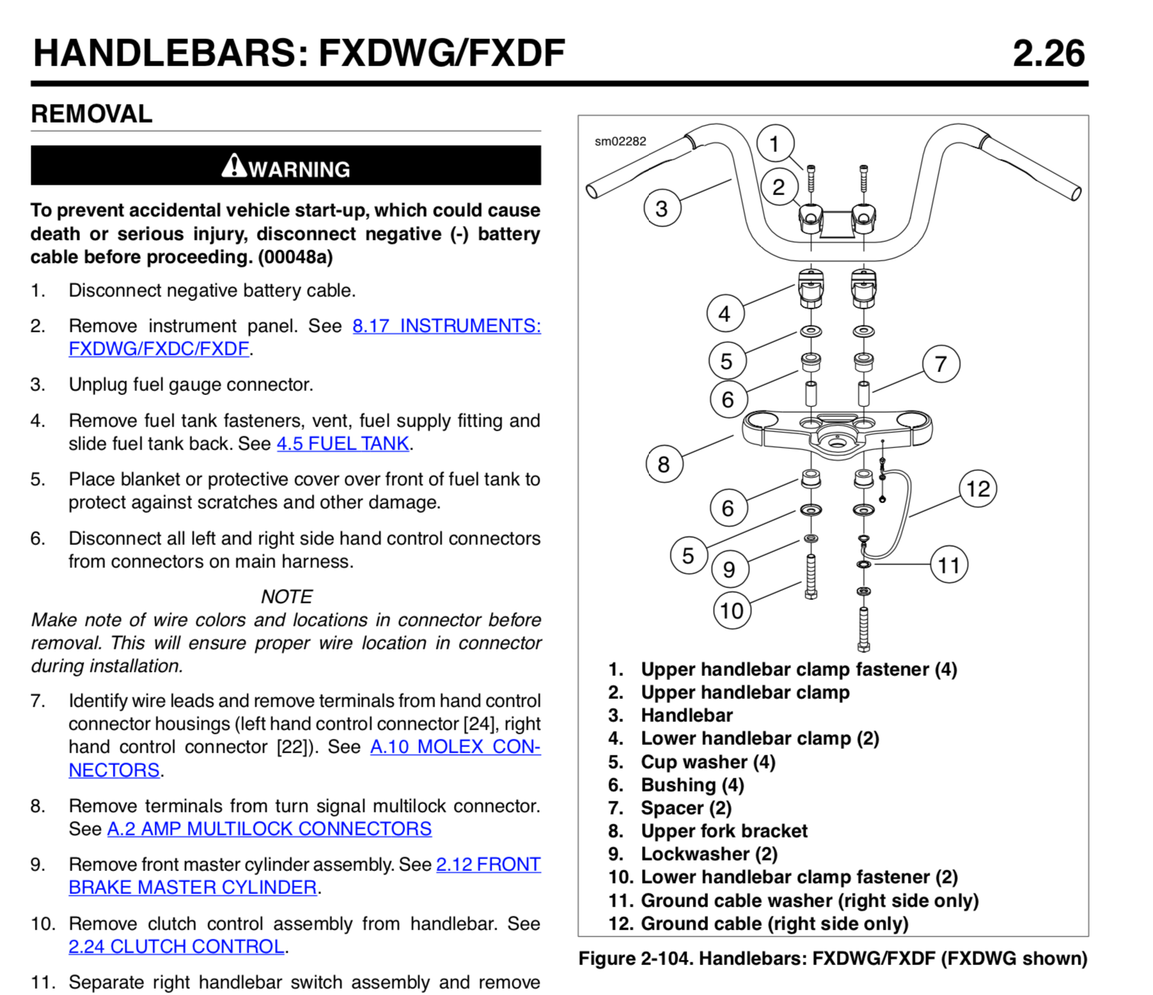

Brand new member here. I'm thinking about installing some pull back risers ( HD part 56267-09) on my 2008 Fat Bob. My hope is to be able to sit up just a touch more over the stock riding position. I know this has been discussed in posts I've read from years ago but I was hoping someone who has completed the job themselves could give me a solid clear answer. First and foremost, is it a difficult job to do yourself? I'm fairly mechanically inclined but don't want to start something only to realize I should have gone to the dealership. Two, if I do decide to the job myself, will I need to replace any of the cables? Any information would be greatly appreciated.

I have them on my fat bob. Super easy to install and the stock cables fit. Two riser bolts and four clamp bolts....done. While your doing it replace the stock rubber riser bushings with poly or solid to eliminate any flex.
I would get a service manual or a clymer manual at minimum of you want to do your own work on the bike.

Cool! Thanks for the info. I actually have the HD service manual but for some reason the FDXF options are always the exception. When I looked at the job in the manual it actually suggests removing a lot of stuff (see the pic I attached) Figured I'd go to the forums just to double check. I love the aggressive style of the stock set up but on longer rides I do feel the need to arch the back now and then. Do you lose the aggressive style after this mod? Can you expand on riding changes after you made the switch? Thanks again.
