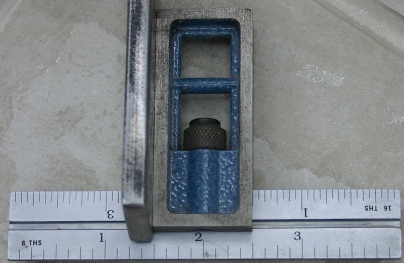

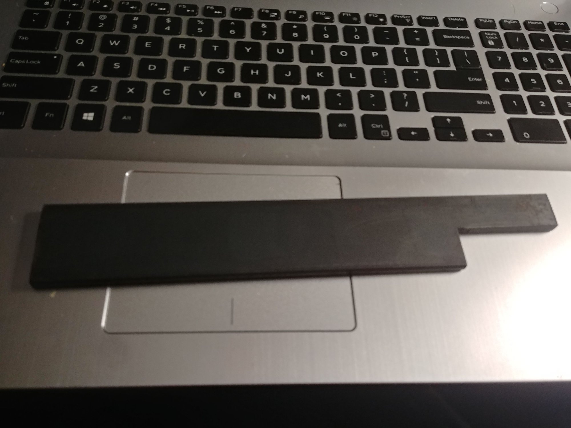

Here's the one I made to do my 99.
Not perfect, but it worked fine.
1.5" x .25" steel bar stock. 9.43" overall length. Notch is 2.00" x .75"

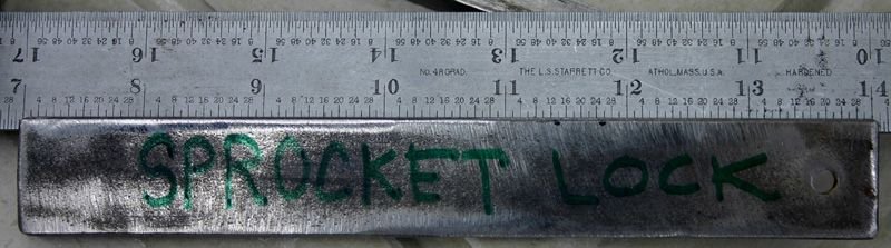

this is what I made to do my 006. may be different on the earlier models. I kinda doubt it tho.
or, like Senior said, wood works too.
7.125" x 1" x .25"

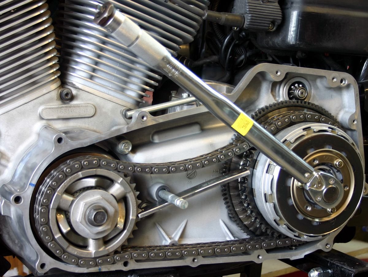

A craftsman 3/8 ( I have two that are slightly different lengths and I use the shorter one) ratchet fits perfectly between the teeth of my clutch basket and compensator.

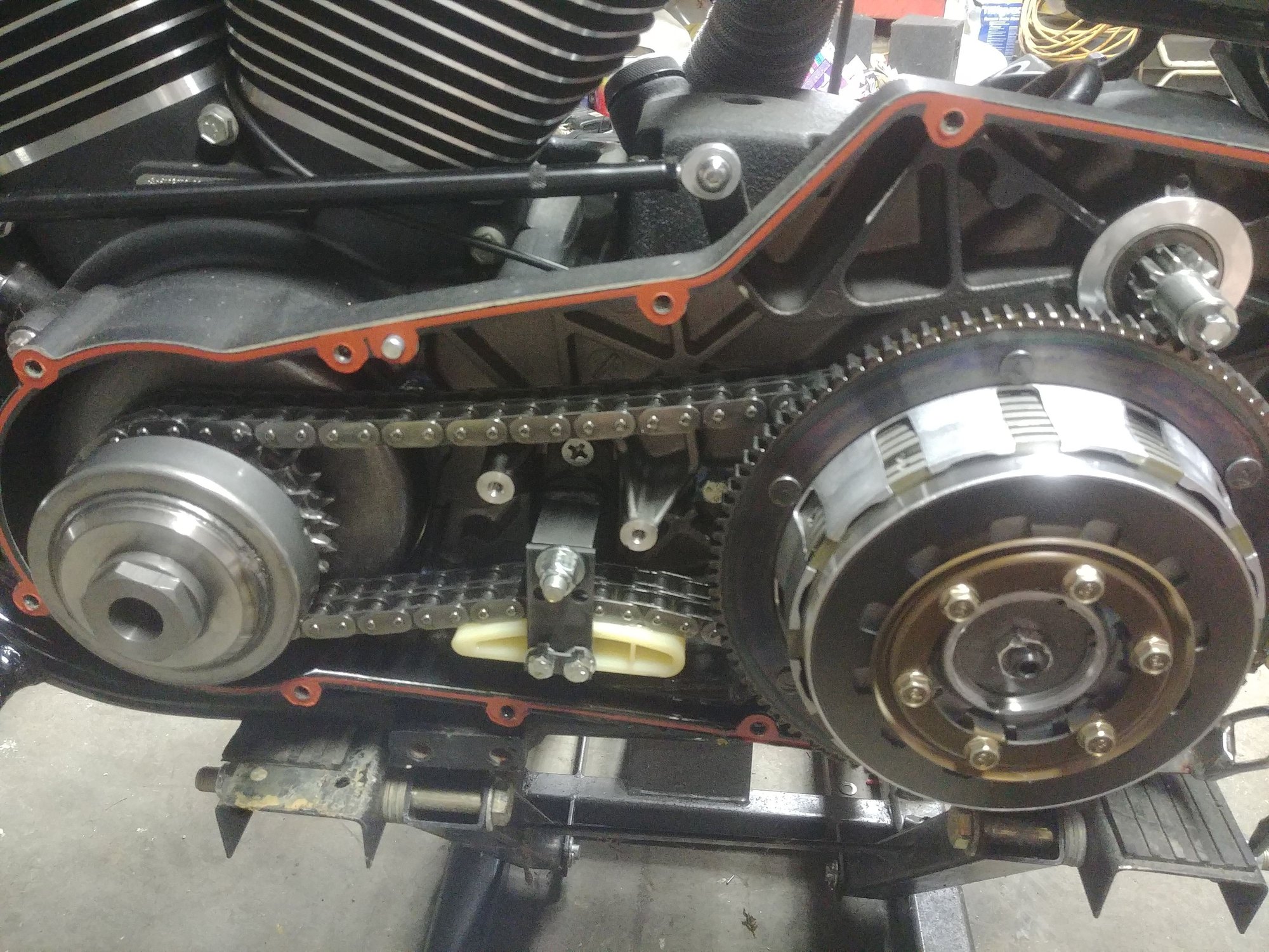

Lots of stuff in the way on a 5 speed.

Note to the folks that may not have done this job before, the primary chain tensioner must be removed first, then you can use a lock bar.
