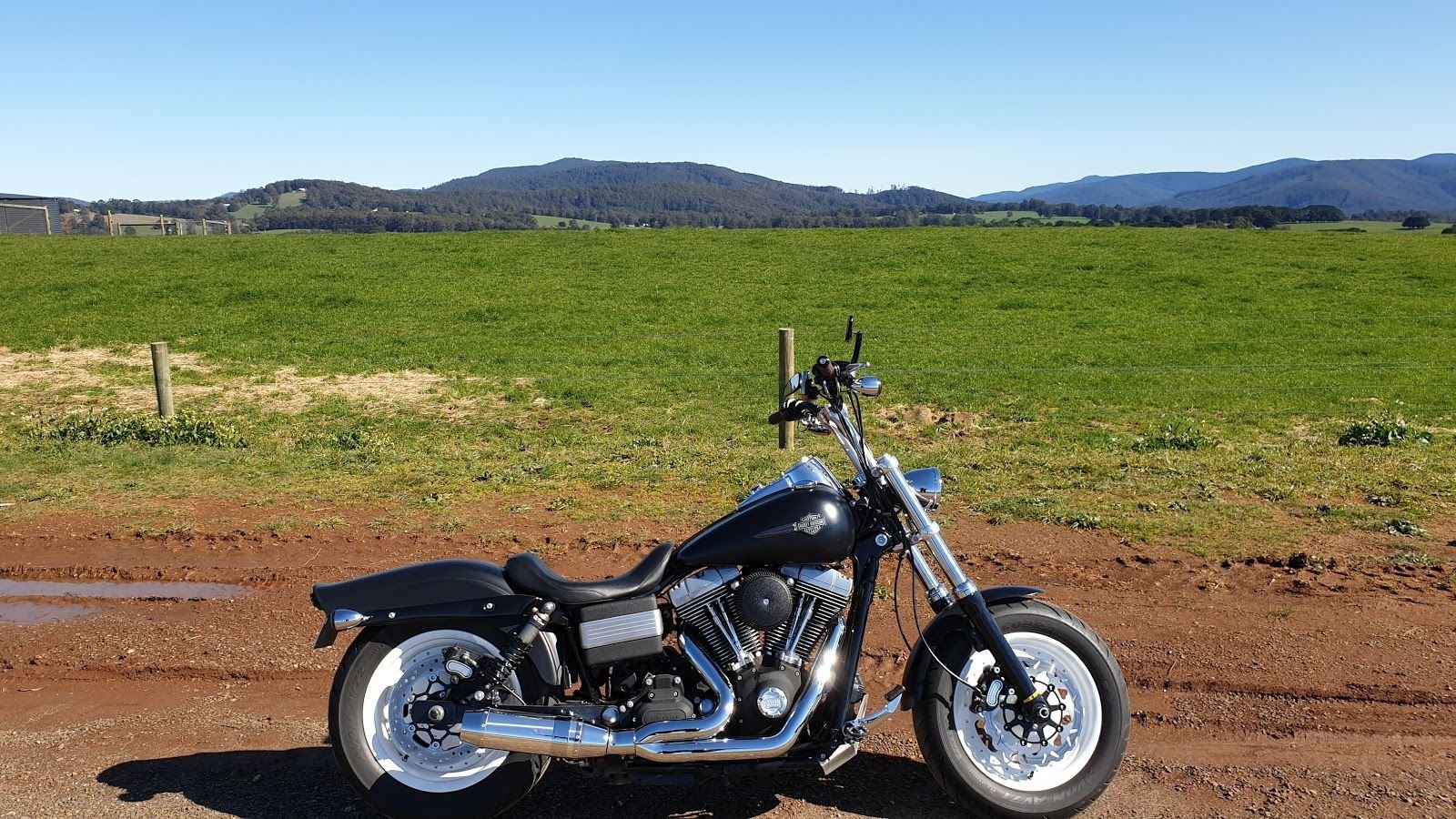

I have 11" Pro Action shocks on one of my bikes.
They were built to order to suit my weight and riding style. Despite being a lowered shock they have more travel than the stock dyna shocks or the progressives on my other dyna.
But the Pro-Actions ride the best out of the three.
Just remember that the difference between an 11" and a 12" shock is less than that in terms of ride height. I Fitted higher clearance pegs and exhaust so I still have the same cornering clearance as a stock height bike.
