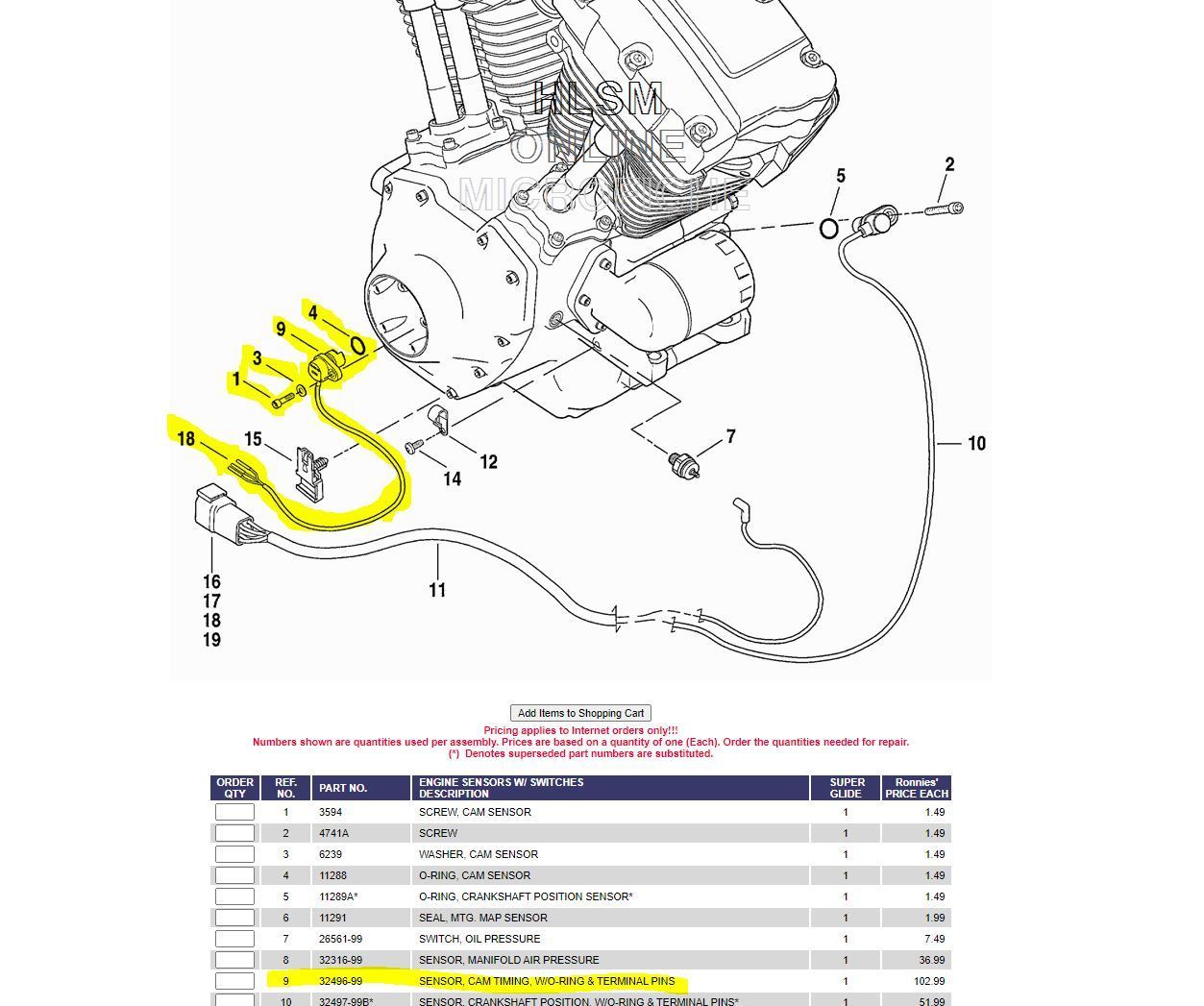

So, I noticed the carb gasket that goes on the air filter backing plate was in shambles, so I replaced it yesterday hoping it was just sucking too much air. That was not the case. I have gotten side tracked the last few months with many other projects, but the Harley is coming back up on the list. I still need to clean the carb, and I havent replaced the plug wires. I replaced the coil because my old coil was physically broken. The problem feels like loss of spark which seems like it should be a timing issue. I've attached a picture below of what I think may be the problem, but I'm not sure. I haven't traced it back yet.
