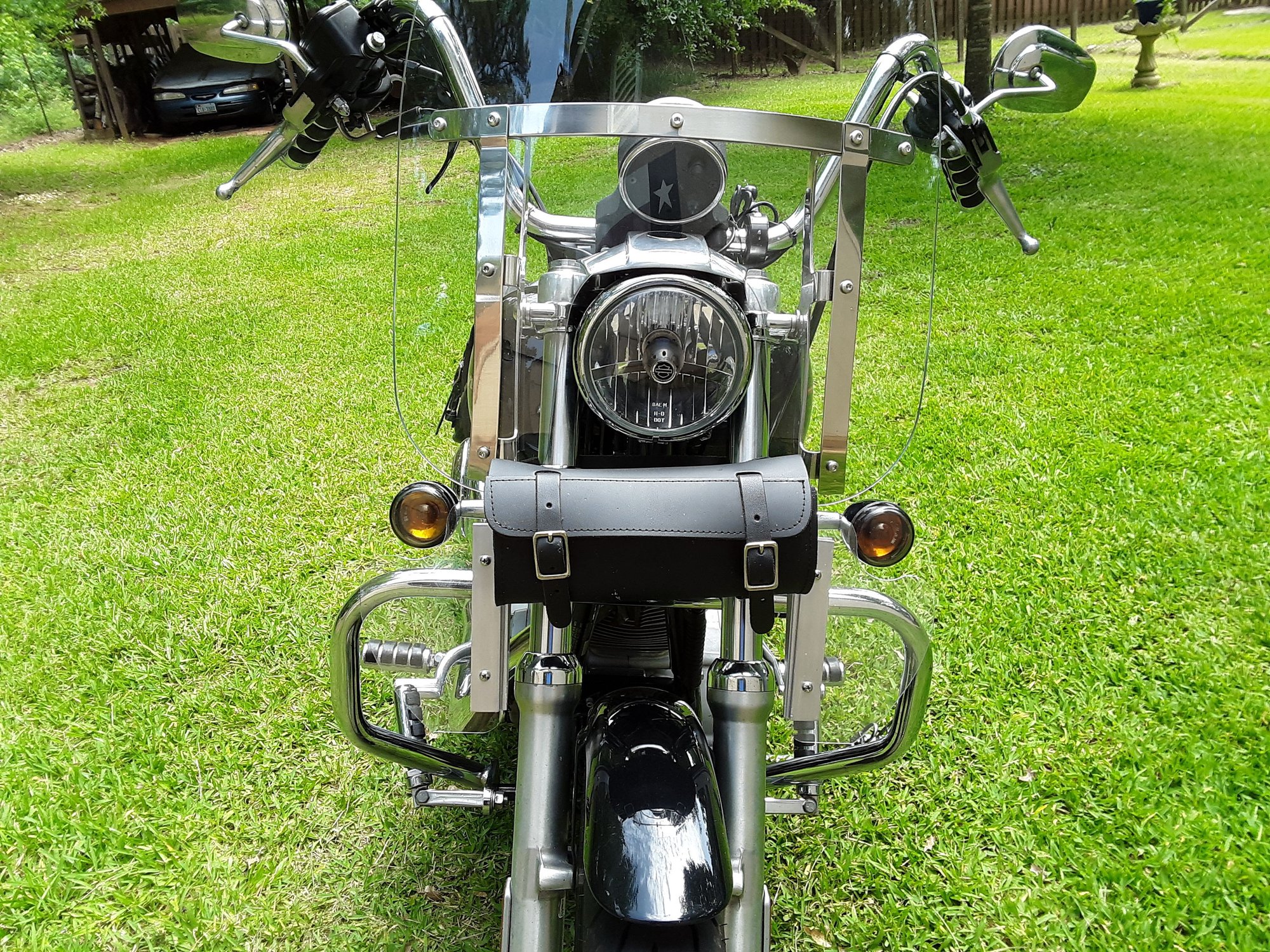

A helmet with a beak (sun shield above the eyes) will cause buffeting. A full face helmet with the shield closed will help a lot with the buffeting problem.
For something to do, I made these lowers using windshield quick detach clamps, aluminum pieces and clear stuff from hardware store. They move the air flow down and away, and I feel like riding in a bubble, even with a helmet and beak. The tool bag help also. You can buy ready made lowers. Check with the sponsors on the right.
I don't use them much as the FF helmet works well. I don't use the shield unless (sometime) I'm out for a all day ride. Just an old man riding in the wind. :-)

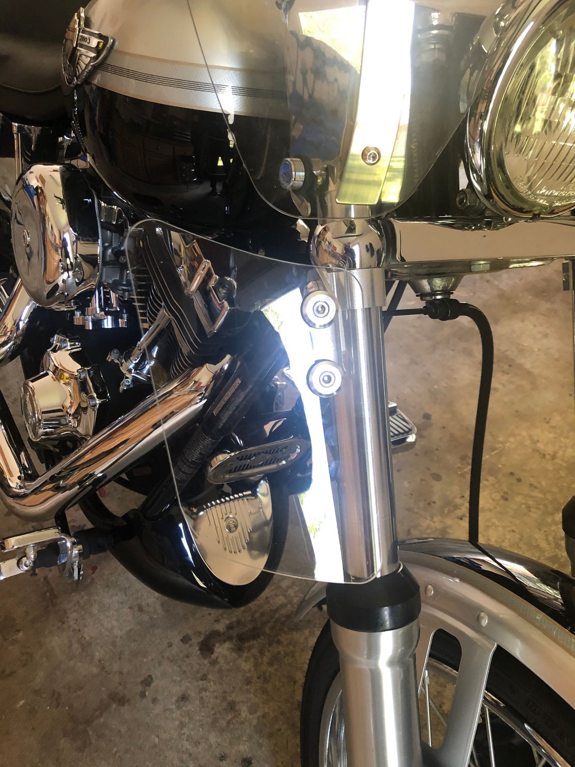

These are Memphis shades, made a BIG difference. I can now read signs on the freeway haha! Everything will probably come off once it warms up again but I won’t use my full size windshield without them.

I use those Memphis Shades one too, on long trips. I agree they make a big difference and, from more than a few feet away, they basically 'disappear' visually, which is nice...
