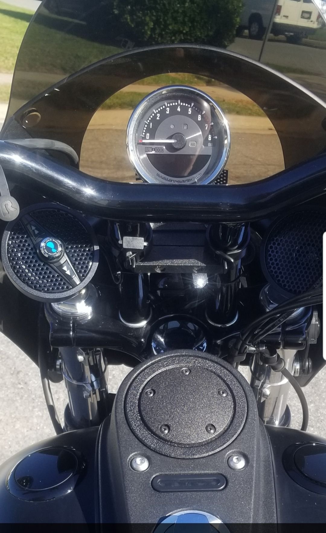

I have an 01 FXDX and I installed some riser bars with a 1in pullback now my speedo/tach are mounted almost 90 degrees so it's rather difficult to read them while riding.
I'm pretty sure there is a way to build a bracket or something to get it mounted back in a better angle but geometry was never my strong suit. First I was like I can just put a whim under it but that would only raise it up not change the angle. I am concerned though if I make a bracket of some sort will vibrations be an issue, and should I just make something out of like 1/8" steel or something?
Can someone post a pic or a diagram of what I need to build or buy to fix this? Because I can't get an image in my head of what it needs to look like.
In the pics in case it's unclear the bracket is held in by the 2 bolts on the top and goes straight across.

I'm not familiar with that gauge mounting so there may be an obvious reason this won't work...but...why not just bend the mounting tabs?
Its pretty small of a area and its cast aluminum so bending it will likely snap it off, can't really heat it prior to bending with all the wires and everything. One of my first ideas was to just bend it, till i looked at it closer and realized it was prob a bad idea.
