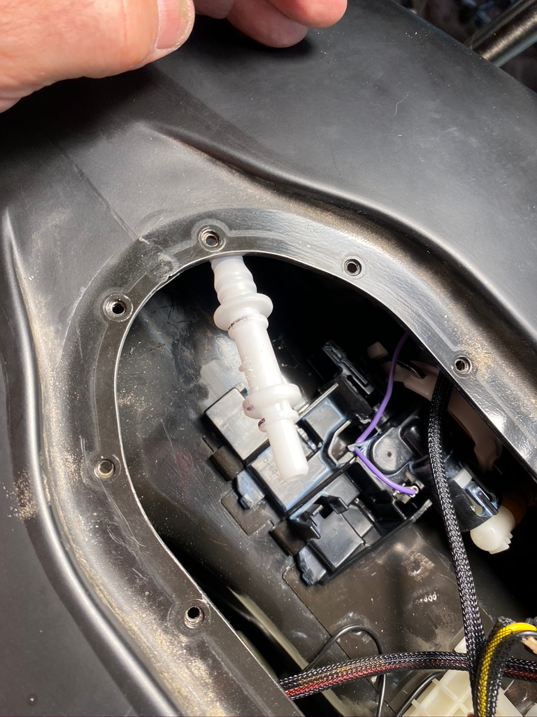

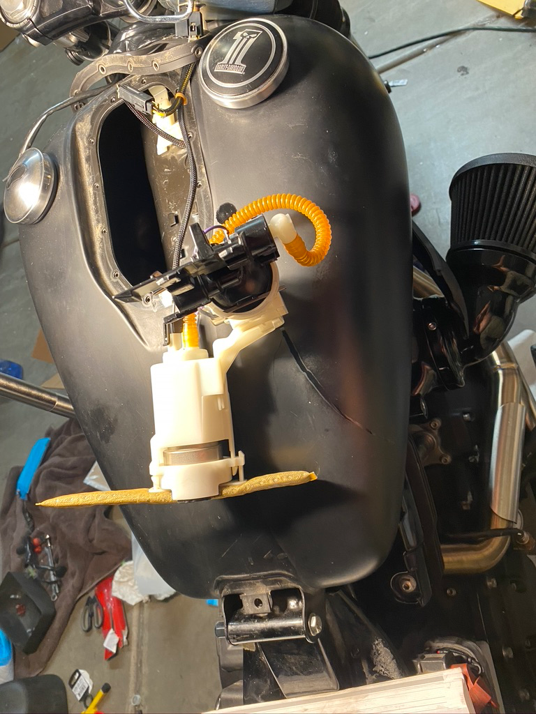

I'd start with replacing the check valve line, the fuel filter and the pick-up sock- might want to go ahead and either get a fuel pump rebuild kit or go the Gates submersible line thing. Bit over $100 for new parts- Dennis Kirk has the stuff. Easy Peasy repair. You know if the orings in the check valve are rotten likely stuff in the tank is shot.
New check valve line
The pump assembly- rotate towards the front of the bike and gently lift it out
Uh huh...
Dont follow steps in the manual...frustrating; pull up tab on the left, slide assembly forward a bit and gently lift then you can get both fingers on checkvalve line quick release

thank you sir. Great pictures and it was the in tank fuel line from fuel pump to disconnect valve. It had a big crack inthe line and it crumbled when taken out thank you. Semper Fi
